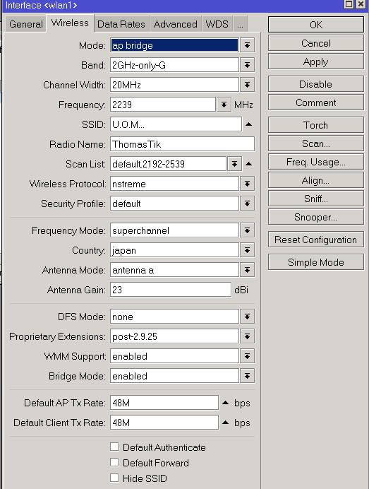

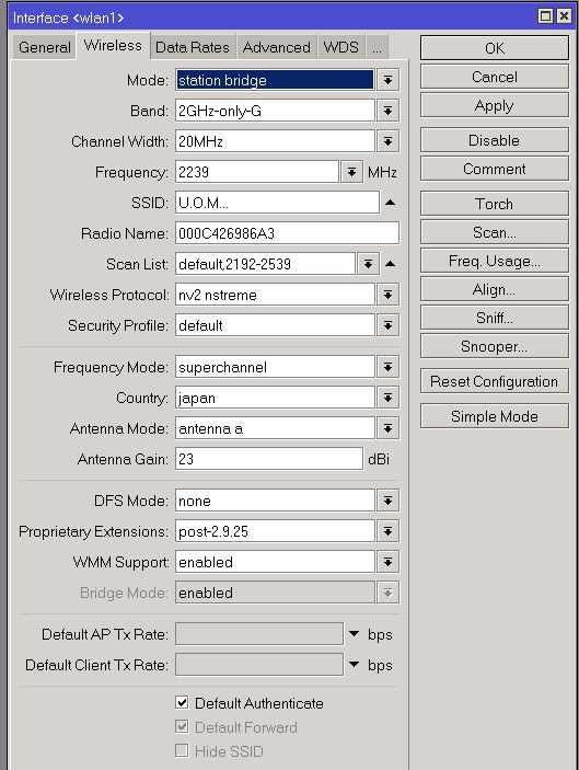

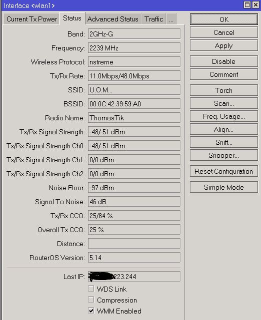

This is my configuration (not sure if enough info for you )
AP side
client side

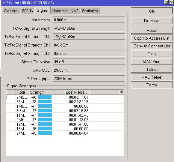

signal at the AP side

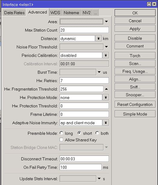

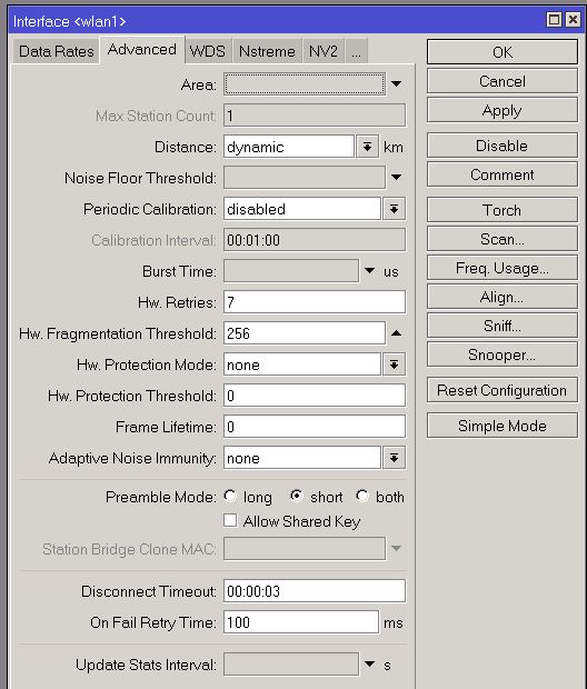

Here is some more
AP
client
status client
Is it the best channel you found?
What antenna exacly are installed on this link?
You have to strong signals. Lower tx power on both sidesw for 3-4 steps. Increase Hw-retries to 10. What cards are you using? I think this cards are 2 chains cars, so can support 802.11N standard. Set link for N-only - it also should helps. Leave hw-fragment-treshold disabled.

You’re using a channel that’s outside the standard 802.11b/g range. Are the grid antennas designed to be used with 2239 MHz ?
Haha. It’s funny no one else noticed this. What is the range of your antennas?

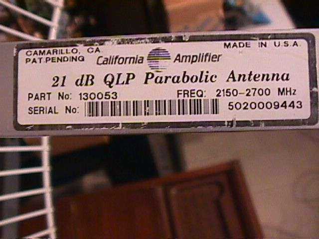

I discovered that my antennas -that I bought and installed a long time ago- are California Amplifier 24 dBi QLPP Parabolic Antennas!! similar to this but 24db
http://www.calamp.com/products/mmds-transceivers/parabolic-antenna-assemblys/parabolic-antennas
their range is 2150 - 2700 so there shouldn’t be a problem with channel freq.

The only thing is that the antennas are “QLP” (Quasi Log Periodic) which I’m not sure of what this stands for.
The fact is that they have an outstanding performance with my old Aironets.
The channel is totally free.
Would it matter if I installed an amplifier? the microcards are already 300mW… I have experimented with reduced power and things get only worst (CCQ 10%).
At the moment I’m testing different channels in case this will make a difference…
