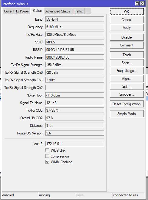

Im setting up a 200m link with 2x RB711GA 5Hn, the antennas are StationBox Mikro, they have dual polarity, so does the RB711.
I have followed the Transparent bridge with mpls/vpls guide. The wireless status page shows that we have 130 Mbit Tx, but only 6 Mbit rx
Sometimes it says 130/130.
However, the reallife transferspeeds between two computers at each end is only 3-5 Megabytes/sec one way, the other way its only 500 kb/sec. I was hoping for at least 10 MB/sec both ways.

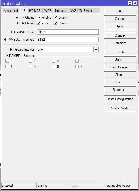

So this makes me wonder if the mimo / DP is incorrect. Under the “HT” tab, wich chains should be used for what? And does it matter wich pigtails goes to wich port?
I see the Mac adress winbox uses for the RB are changing when i change the ports for the antennas.
And last, what transferspeed between two computers should I be getting?
Try to check all 8 HT AMPDU boxes and use long HT GUard interval. Does that help?
Update:
The tx/r rate now shows 270/6. But as soon as i start to transfer data between computers, rx jumps up to 168.
It now maxes out my 100mbit nics :slight_smile:
Im not sure what caused the big difference, but I switched over to use “superchannel” and also selected higher channel width.

NV2 has the highest throughput. I’m not sure the guard interval or priorities helped you. I think you were on a busy channel and the channel change fixed your problem. I would put them back to default and use NV2. Also your signal strength is WAY too high. You need to turn down your power.
Do a frequency scan and see what’s being used around you.

Also found out that using “20/40 HT above/below” enables the second channel. And i think this i what is necessary to get the highest speeds with dual polarity.
I was using a mpls transparent link at first, but have now configured the RBs like a regular ap-bridge and station-bridge. Link speed shows 300/300 under load. Falls back allot during idle, i guess this is the normal behaviour for NV2.

signal 2dbm :laughing: :laughing: :laughing:
You think it’s too high? :confused:
doh, signal must be in -65…-40 for best results.
I was being sarcastic

The signal strength is beause they where both in the same room. I have turned it down, but maybe not enough.
