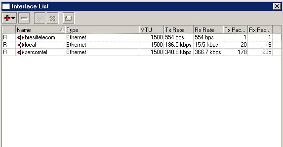

My PUBLIC interface, conected to Internet with Fixed IP, is having more trafic that LOCAL interface , conected to LAN. The trafic is going through from PUBLIC to MikrotiK, but it doesn´t go out to LAN in same numbers.
In attach, picture of Interface windows.
Please, if anyone can help me to discover what is the problem!!!
use Tools → Torch to see the traffic
OK, but what kind of trafic is wrong?
but what kind of traffic do you see? =)

I could see that this traffics still hapen when I disconect LOCAL interface.
