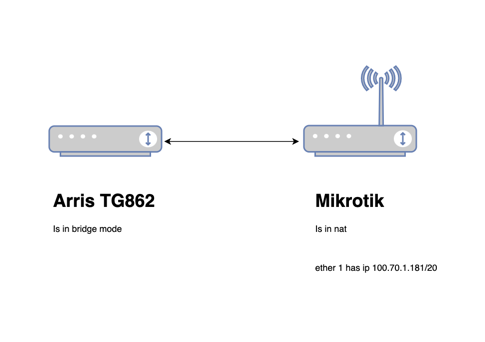

In the ether 1 i have 100.70.1.181/20 (from my ISP)
In the rest of my ports and wifi the ip is the default 192.168.88.1/24

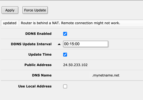

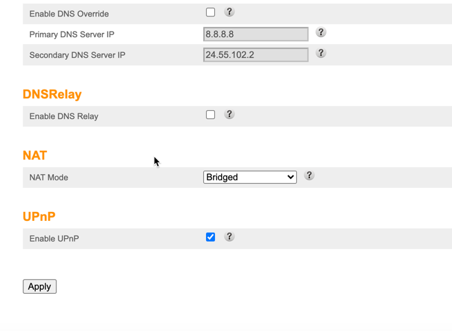

The Arris modem is in bridged mode.

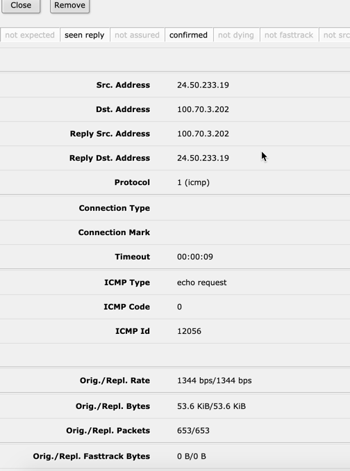

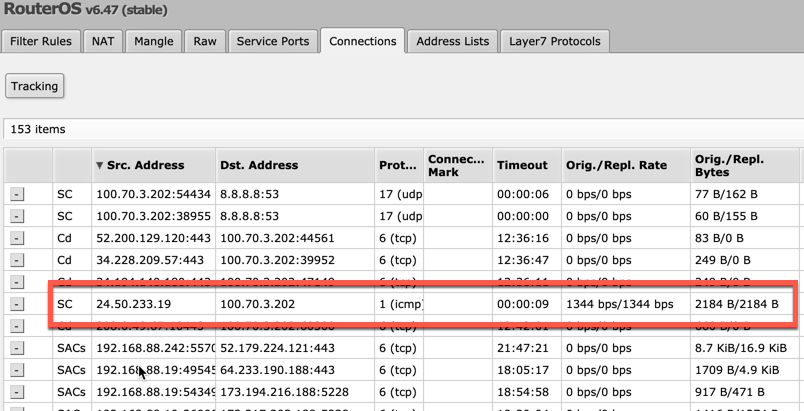

I see this in the ip firewall conections when i ping the public ip.
on this screen it is better appreciated
