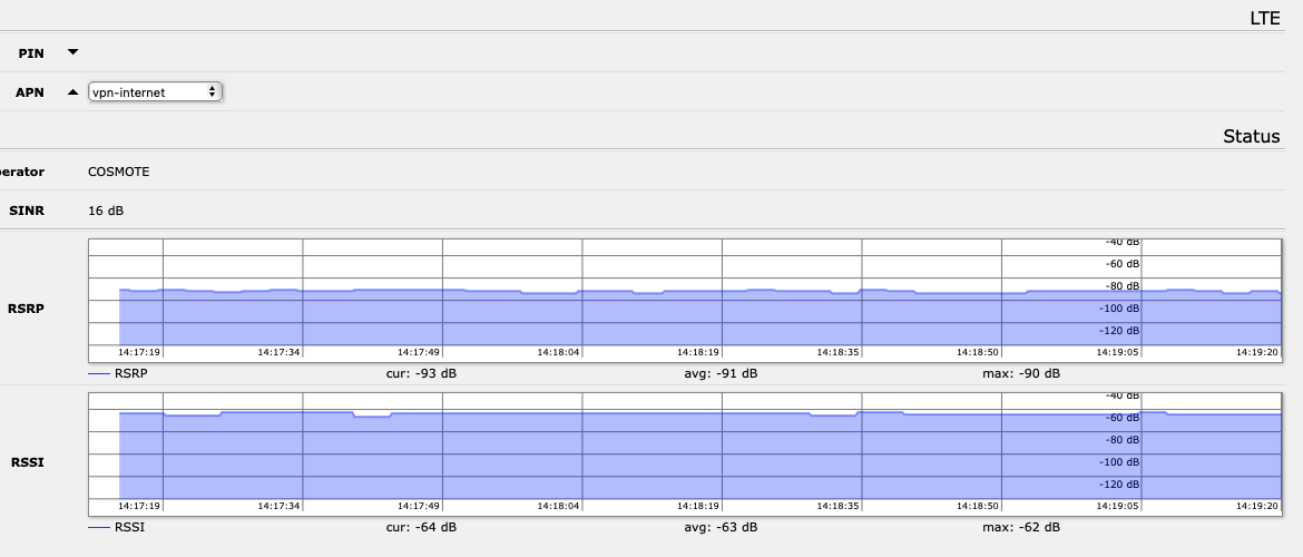

The issues now with the newly purchased LTE18 router is:
  1. I do not get a public IP, even with the same exact SIM card. To be more clear, I put the SIM card in LTE6 router, everything works like a charm, I take it off and put it in the LTE18 router my IP is 10...* Obviously I also set the correct APN. Is it something that has to do with the carrier or a configuration is needed?
  2. LTE18 router does not provide me with a, let’s say, “static” VPN address in the format *.sn.mynetname.net. What alternatives do I have?
    Pictures here:

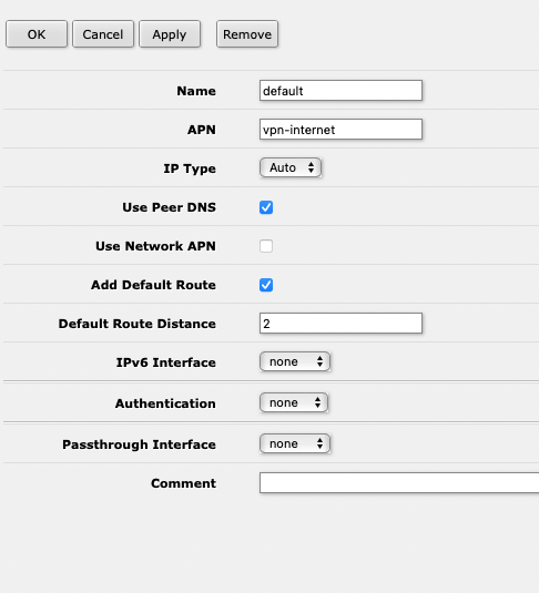

I managed to address the issues I have been facing, so I am posting what I found for newbies like me that they are trying to figure things out.
It seems that there is a choice “Use Network APN” (not existent in lhg lte6) that the APN is automatically set through the network. From my point of view if this is set then it does not matter what the user sets through the quick set interface.

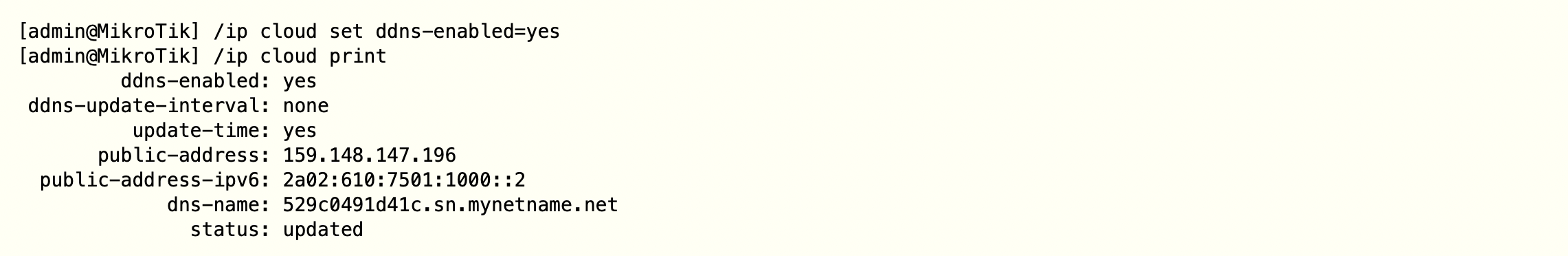

  1. LTE18 router does not provide me with a, let’s say, “static” VPN address in the format *.sn.mynetname.net. What alternatives do I have?
    Pictures here:
In the LTE18 it is needed to enable the DDNS through the terminal and then get it through there. It is not shown in the quick set Interface
Hope these will help somebody
