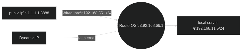

I want to connect through public ip using 8888 port by wireguard then:
  • some using for internet
  • some access to local server
Note:
using
  • Dynamic IP just for internet not through (prevent) public ip
  • what to not prevent for wireguard to work well?

Thanks for reply
ok,i will try to be more clear
  • connect from outside using wireguard (public ip) with static port and none default (i set 8888 as example)
  • then get inside router using gateway ip of wireguard like 192.168.55.4/24
the connection:
  • connect for access local server
  • connect for access internet wanna the internet go through dynamic IP not through public IP
  • sometimes both
Notes
  • i wanna to use best security so like for local server just open specific port and what ports shouldn’t closes that used for wireguard
Best Regards

What I think you may be describing is
a. you have a mikrotik router with an an accessible public IP which will act as your wireguard server vice the rest which are wireguard clients in terms of the initial connection.
b. you have unknown other devices, will assume none of them are mikrotik device but maybe laptops and iphones for example.
c. you have a server on the Mikrotik device.
d. you only want people to be able to reach the server via the wireguard tunnel and not via the public IP of the router.
e. you want same people to be able to use the internet of the mikrotik router via the wireguard tunnel.
