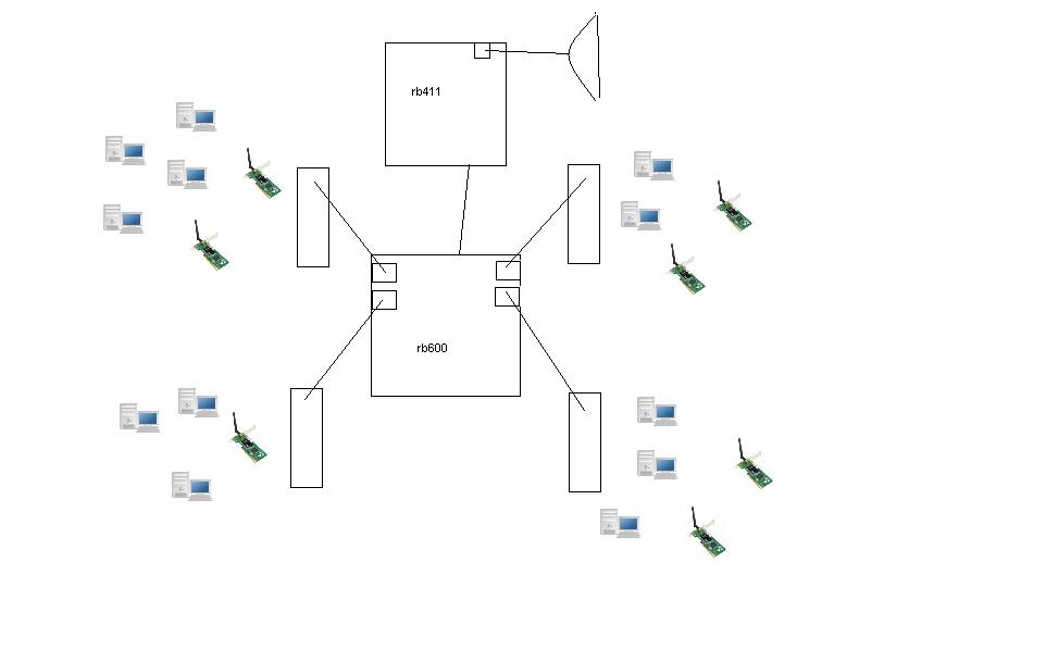

first i will tell my configuration.
on picture i have rb600a and rb411ah.
rb600 is connected to 4 sector antennas, and on antennas there are connected clients, with, nsl5, rb411, wireless pci cards and so on. some of them dont support routing so they are connected to rb600 directly.
with rb411ah i am using p2p link and rb411ah is connected to rb600a with ethernet.
all rb600 ports are bridged and on p2p link i have wds.
also i am using mac authentication on wireless with usermanager v4.4.
so i need solution.
Now i have public ips range /24. i want to use this ips for all clients.
it will be easy with clients who have router, becouse they cannot access my network they are behind of router. but clients with pci wireless devices can access my network becouse all ports are bridge on rb600 and they can use some programs and catch packets and do some atackes. i unchecheked default forwarding but of course it didnot help, becouse all ports are bridge. another solution is to disable bridging and use masquraiding but with masquraiding how i can use public ips.
is there any solution for example to block users to access network with bridgeing or use masquraiding or other routing things.
