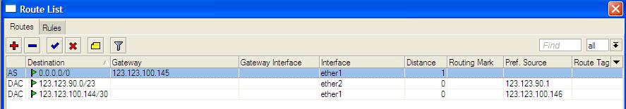

I have a problem with configuration public IP’s in LAN. My ISP give me a 2 C class of IP’s, I don’t exactly know how should to be configured routing between me and ISP. My routing configuration:
#.......DST-ADDRESS....................PREF-SRC........GATEWAY-STATE .....GATEWAY...................DISTANCE.....INTERFACE
.0.A.S..0.0.0.0/0...........................................reachable............... 123.123.100.145..................1..........ether1
.1.ADC..123.123.100.144/30.........123.123.100.146..................................................................0..........ether1
.2.ADC..123.123.90.0/23..............123.123.90.1.....................................................................0..........ether2
PC in LAN configuration: IP: 123.123.90.5 netmask: 255.255.255.0, gateway: 123.123.90.1
My ISP create /30 class betwen us.
ISP(123.123.100.145)------(123.123.100.146)eth1MTeth2(123.123.90.0-123.123.91.255)
123.123.100.145/30 ------- 123.123.100.146/30 eth1MTeth2 123.123.90.0/23

First - your LAN IP address should be (on the PC) 123.123.90.5 netmask: 255.255.0.0 (or /23)
Next, in Winbox, under /IP routes, go to rule tab, rule should be src-addr=0.0.0.0/0 dst-addr=0.0.0.0/0 action=lookup table=main
This tells ROS to lookup any IP (hence the 0.0.0.0/0) going anywhere and use table Main to route it.
Now if the above does not work then your ISP has probably not properly routed 123.123.90.0/23 to your end of the /30 connection.
R/
Your ISP should route your /23 public subnet via your IP 123.123.100.146/30 and than it should work.
Regards.
Faton

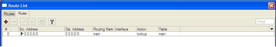

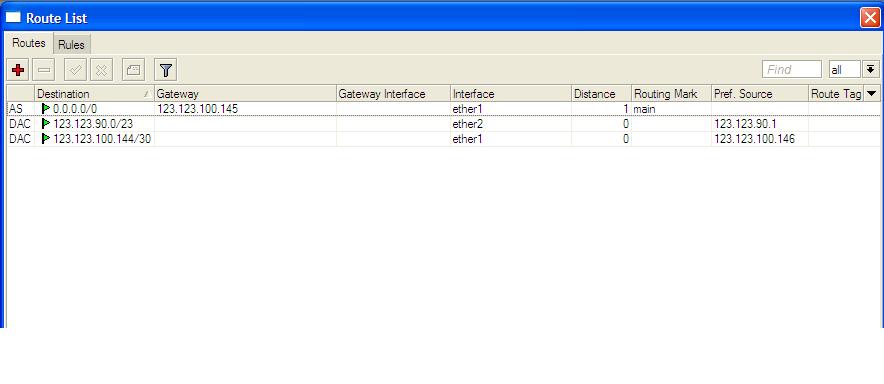

Hi
I change my config as galaxynet say:
0 src-address=0.0.0.0/0 dst-address=0.0.0.0/0 routing-mark=main action=lookup table=main
PC: IP: 123.123.90.5, netmask 255.255.254.0, gateway: 123.123.90.1
Internet work’s only if the masquarade is enable, if disabled nothing - NAT is empty.
What is wrong ?
Regards
B_U_L_I -

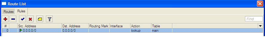

You have a routing mark in the route table. Remove the routing mark… I never said to add a routing mark…
Should be:
0 src-address=0.0.0.0/0 dst-address=0.0.0.0/0 action=lookup table=main
If it still does not work then call your ISP and verify that IP: 123.123.90.0/23 is in fact routed to 123.123.100.146
Sory my mistake. I correct and still not working. ISP has something wrong ?
Regards
B_U_L_I -
Yes - it looks to me like the ISP has not routed the IP block 123.123.90.0/23 to 123.123.100.145
If you want to make sure - then dump your config here on the forum and let’s make sure everything is right…
R/

/ip accounting web-access
set accessible-via-web=no address=0.0.0.0/0
add address=123.123.100.146/30 broadcast=123.123.100.147 comment="" disabled=no
interface=ether1 network=123.123.100.144
add address=123.123.90.1/23 broadcast=123.123.91.255 comment="" disabled=no
interface=ether2 network=123.123.90.0
set allow-remote-requests=yes cache-max-ttl=1w cache-size=2048KiB
max-udp-packet-size=512 primary-dns=194.204.152.34 secondary-dns=0.0.0.0
set enabled=yes generic-timeout=10m icmp-timeout=10s tcp-close-timeout=10s
tcp-close-wait-timeout=10s tcp-established-timeout=1d
tcp-fin-wait-timeout=10s tcp-last-ack-timeout=10s
tcp-syn-received-timeout=5s tcp-syn-sent-timeout=5s tcp-syncookie=no
tcp-time-wait-timeout=10s udp-stream-timeout=3m udp-timeout=10s
add action=masquerade chain=srcnat comment="" disabled=no
/ip firewall service-port
set ftp disabled=no ports=21
set tftp disabled=no ports=69
set irc disabled=no ports=6667
set h323 disabled=no
set sip disabled=no
set pptp disabled=no
/ip neighbor discovery
set ether1 discover=yes
set ether2 discover=yes
set ether3 discover=yes
/ip proxy
set always-from-cache=no cache-administrator="webmaster" cache-drive=system
cache-hit-dscp=4 cache-on-disk=no enabled=no max-cache-size=none
max-client-connections=600 max-fresh-time=3d max-server-connections=600
parent-proxy=0.0.0.0 parent-proxy-port=0 port=8080
serialize-connections=no src-address=0.0.0.0
add comment="" disabled=no distance=1 dst-address=0.0.0.0/0
gateway=123.123.100.145 scope=30 target-scope=10
/ip route rule
add action=lookup comment="" disabled=no dst-address=0.0.0.0/0
src-address=0.0.0.0/0 table=main
/ip service
set telnet address=0.0.0.0/0 disabled=no port=23
set ftp address=0.0.0.0/0 disabled=no port=21
set www address=0.0.0.0/0 disabled=no port=80
set ssh address=0.0.0.0/0 disabled=no port=22
set www-ssl address=0.0.0.0/0 certificate=none disabled=yes port=443
set api address=0.0.0.0/0 disabled=yes port=8728
set winbox address=0.0.0.0/0 disabled=no port=8291
/ip socks
set connection-idle-timeout=2m enabled=no max-connections=200 port=1080
/ip traffic-flow
set active-flow-timeout=30m cache-entries=4k enabled=no
inactive-flow-timeout=15s interfaces=all
/ip upnp
set allow-disable-external-interface=yes enabled=no show-dummy-rule=yes
/queue interface
set ether1 queue=ethernet-default
set ether2 queue=ethernet-default
set ether3 queue=ethernet-default
/radius incoming
set accept=no port=1700
/system clock manual
set dst-delta=+00:00 dst-end="jan/01/1970 00:00:00" dst-start="jan/01/1970
00:00:00" time-zone=+00:00
/system console
add disabled=no port=serial0 term="vt102"
/system health
set fan-mode=auto use-fan=main
/system identity
set name="MikroTik"
/system logging
add action=memory disabled=no prefix="" topics=info
add action=memory disabled=no prefix="" topics=error
add action=memory disabled=no prefix="" topics=warning
add action=echo disabled=no prefix="" topics=critical
/system note
set note="" show-at-login=yes
/system ntp client
set
#error
/system upgrade mirror
set check-interval=1d enabled=no primary-server=0.0.0.0
secondary-server=0.0.0.0 user=""
/system watchdog
set auto-send-supout=no automatic-supout=yes no-ping-delay=5m
watch-address=none watchdog-timer=yes
/tool bandwidth-server
set allocate-udp-ports-from=2000 authenticate=yes enabled=yes max-sessions=10
/tool e-mail
set from="<>" server=0.0.0.0
/tool graphing
set store-every=5min
/tool mac-server
set FIXME disabled=no interface=all
/tool mac-server ping
set enabled=yes
/tool sniffer
set file-limit=10 file-name="" filter-address1=0.0.0.0/0:0-65535
filter-address2=0.0.0.0/0:0-65535 filter-protocol=ip-only
filter-stream=yes interface=all memory-limit=10 only-headers=no
streaming-enabled=no streaming-server=0.0.0.0
/user
add address=0.0.0.0/0 comment="system default user" disabled=no group=full
name="admin"
/user aaa
set accounting=yes default-group=read interim-update=0s use-radius=no
/system gps
set enabled=no set-system-time=yes

Your configuration looks correct… I am guessing that your ISP has not routed your public IP block correctly.
