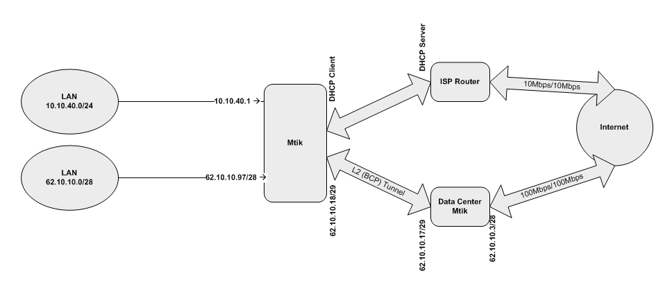

You will see three VPNs, namely Watson, Spencer, and Valley. At this point in time I’m testing with Watson.

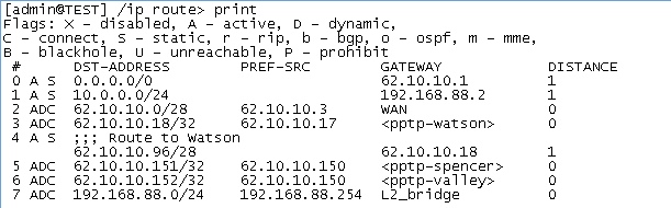

I’m assuming that my problem is at the Data Center so I’m attaching a snapshot of the Routing Table from it.

If it shows datacenters IP address then most likely there is a nat rule.
MRZ,
You were correct, there was a NAT rule that I missed. I already removed it, but now I don’t have access to the Internet. I can only ping as far as the WAN interface
of the router at the Data Center.
Do you have any suggestions/pointers on how to resolve this issue?
