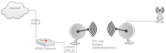

I think im getting lost here. I read some of the documentation on how to use different public IPs on a network. Well heres the issue. I have a private nat network and I want A single piece of CPE I have to be public. Is this possible? Here is my network layout
(Comcast Router)----Public IP----Eth01(MTRB750)Eth02–Private(10.20.20.1){DHCP Sever}-----(MTRB Bridge)~(wireless)~(MTRB Bridge)------(MTRB AP) ~~~~(Client CPE)<— is it possible to have this device be public?
If so how?
The only thing I could figure out how to do is to make that client go out an IP but I need that device to be reachable publicly.

It’s possible with VLAN, I did it with two VLAN-aware switches. Before that I used an EoIP tunnel to bridge through a wireless link so one node on the other end could get a public IP.
VLAN: http://wiki.mikrotik.com/wiki/VLAN
EoIP Tunnel: http://wiki.mikrotik.com/wiki/Manual:Interface/EoIP
Edit: Added a network diagram for illustration purposes.
Will I be able to EoIP over this connection or do I need a true MT link?
The idea is to give CPE that connects to the MT AP a public IP.
