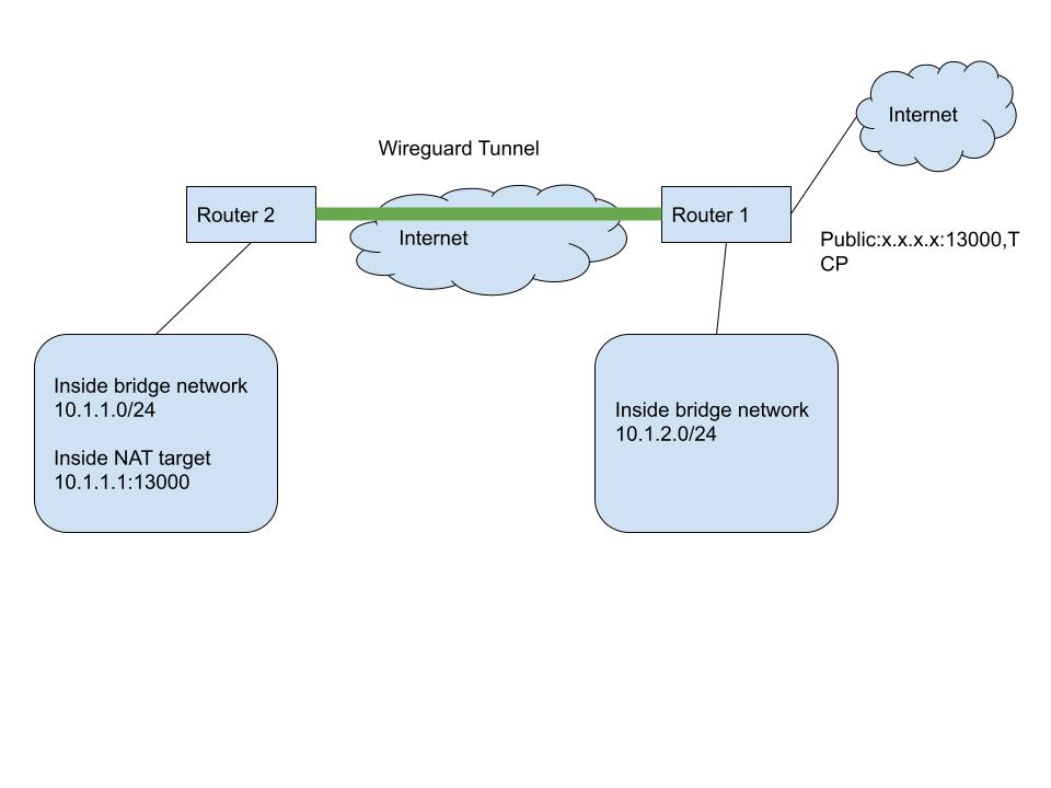

Two routers with a perfectly functioning wireguard tunnel between. Router1 inside systems can reach Router2 inside systems and vice versa without difficulty. The internet service (Starlink) at Router 2 does not accept inbound connections so attempting to public NAT at Router1 and leverage the already in place FW and routing rules for the functioning WG tunnel.

You have a public IP at router 1 which allows the device to act as a Server for the initial handshake
You have starlink at router 2 that does not, but who cares, this will act at a client for initial handshake.
Whats the problem?
As far I can understand, some form of “inbound connections” (DNAT) is required to hit some server behind Router2
Starlink does not support this, hence the construction to have the DNAT take place at Router1 , then route is across WG towards Router2, let it hit the server and make sure the return packets arrive back at Router1 :wink:
Alternative would be to have a DNAT done at Router1, and ALSO SOURCE-NAT (with some 10.1.2.0/24 IP) , then push it down the WG-tunnel and the return packet will automatically come back to Router1 for further processing?
Correct, but that would hide the actual addresses of the clients from the server, which is sometimes not what you want. Your initial suggestion with connection marking doesn’t have this drawback, but yes, it is a bit more complex to configure.

  1. Implement policy-based routing (mangle route) for the specific device on Router2 which outside traffic is forwarded to. On initial review this seems to be the best solution to my default gateway problem at Router2. Most traffic will go to Starlink, and a very small amount will traverse the WG-tunnel and use Routers1 default gateway.and dstnat.
2)Also perform srcnat on inbound packets to put the packets into a directly connected network.

As an update a simple mangle-route on Router2 for the return traffic for the inbound nat’d connection on Router1 did the trick, thank you for all the recommendations.
A new problem has surfaced, regardless of the sniffer interface or filter settings on Router2 when I stop the sniffer the return traffic up the WG-tunnel stops. Start the sniffer and the traffic is passed.

Also, mangle and fasttrack aren’t friends.
Disable fasttrack if you want to keep the current overcomplicated config.
Seems quite simple to me a DSTNAT and a Mangle, what would you propose? Thanks for the fasttrack hint, I figured out after my note last night that the Sniffer if likely turning off fasttrack so the CPU is exposed to all of the traffic. Disabling fasttrack eliminated the need to run the sniffer.
