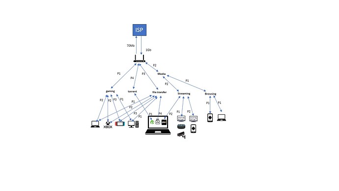

I have a small but busy home network for which I use an Asus RT-AX86U route running Merlin firmware with Cake enabled.
I've recently run into download contention issues which makes me consider using a Mikrotik router as I see they can support Hierarchical QoS.
I know that the router cannot be directly responsible for traffic prioritization from the ISP to me, but by prioritizing outbound packet requests/confirms it should control returned (download) traffic rates.
(My issue was that my kids were both downloading game updates whilst we were streaming Disney. Disney stopped, as game updates took all
available bandwidth and Cake on my Asus router didn't handle that. I don't want to restrict game update bandwidths, and anyway XBOX doesn't provide that capability).
My priority traffic handling order is:
A: Gaming traffic. Always requires immediate handling, lowest latency.
B: Anything to/from my work PC.
C: 'Static' browsing (not counting Tiktok / Youtube style streaming in this).
D: Streaming - to/from particular highest priority devices.
E: All other streaming traffic, equally handled.
F: File transfers, including from gaming devices.
G: torrents
I don't want any class of traffic to have a bandwidth maximum cap. i.e. if nothing else is on the network then torrents should get the full bandwidth.
I would set a minimum bandwidth for everything, just to some TCP sessions dropping in file transfers, for example.
I expect classifying traffic could be hard: how to tell between different traffic types from the same device if they share the same protocols and ports.
I wondered if I can run Cake to classify and prioritize on some child queues, and a different schema on parent queues?
What is the maximum depth of child queues in the QoS tree'?
I have read enough to consider MIkrotik as the best path to try this now. I am not worried about the configuration complexity, I have configured routers and HQOS as part
of my job.
Outside of the QoS I will use the router to enable inbound VPN connections, DHCP, NAT, DNS (forwarding), Firewall, IPv4 only, ISP fall-over and revert-back (USB-connected 4G).
I don't need wifi, I can continue to use the Asus as an AP.
My budget is up to 300 Euro
I access my ISP through their gear running in modem mode.
I attach a diagram in the hope that it helps. P1 is my top priority. P2 less etc.
MIKROTIK is not the answer either, that is if you are intent on content based control.
MT does not have APPLICATION CONTROLS or deep packet inspection so it may not work for you.
MT is a user based and by that I mean IP: based firewall router. So put users into vlans and subnets and then you can control traffic to some degree like queues, and where traffic is allowed to go and how to get there..etc. You can also create firewall address lists of users and control those…
Gaming, access to facebook etc, is not part of that equation
Hopefully others will chime in and give you a better sense of what is in the realm of possible.

I don’t believe it’s that simple. If you prioritize the consoles by IP, they will hog the bandwidth when downloading games and updates, just like with the Asus. If you put the streaming clients above them in the tree, same issue. Circumventing these issues will require port, protocol, IP and size based mangle rules with some limitations. Furthermore, streaming is encrypted on TCP 443 and cannot be differentiated from other TCP web traffic without DPI capabilities. Having a torrent box to “borrow” content is another potential bandwidth hog, even if it’s not seeding 24/7. Workarounds are possible and quite trivial for the gurus here, and the RB5009 is capable of Gigabit internet with various QoS strategies, but coming from Asuswrt implies a big learning curve unless some form of fair queuing or cake is used.

I appreciate now that we cannot classify traffic types except on basic header info (src/dst/protocol/port). No Application Assuranve. I’ll have to make-do.
I wonder if I can make all queues as Cake queues. But still have them in a hierarchy. Perhaps that would allow gaming/small sessions to be prioritised right up the tree, whilst I could still have highest-priority streaming devices further up in the queue hierarchy to take precedence over the torrent server.
