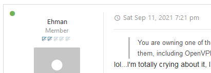

Just out of curiosity? Is the word “crying” the new trend word lately on this forums, I have to admit, I haven’t been in this forums in ages until today…
:confused:
