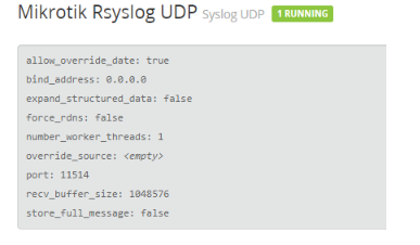

I have configured as the following images but it seems that my Graylog server did not receive any messages (logs) from my Mikrotik and I also tried to create some messages for it

Have you tried using the same port? The listening port at the server has to match the remote port in the RouterOS-syslog-config…
Your Graylog server is listening on port 2514 while your mikrotik is sending the logs to port 1514

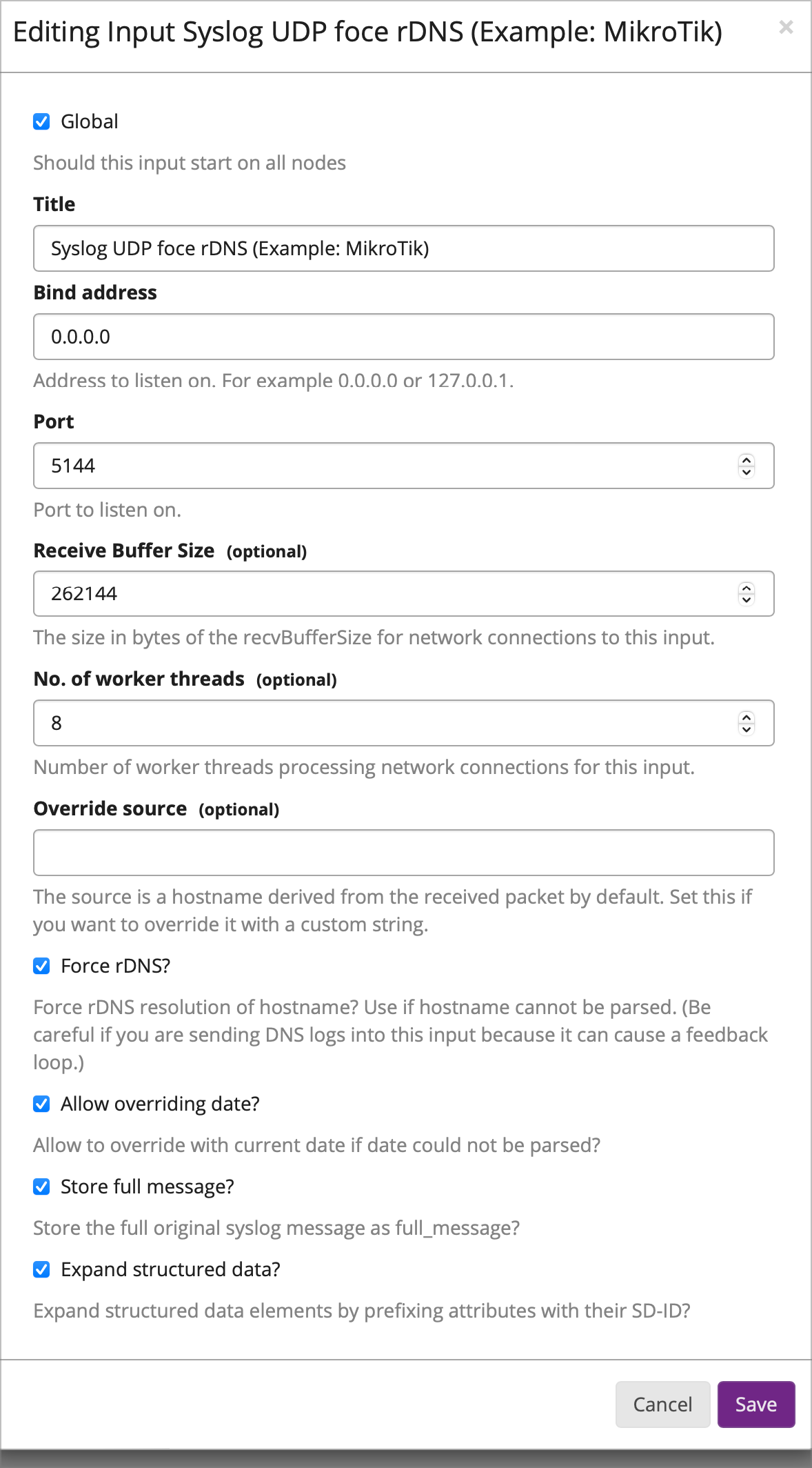

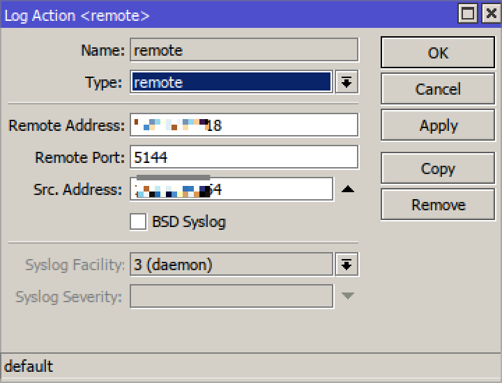

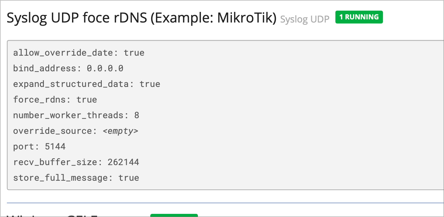

It works fine for me:

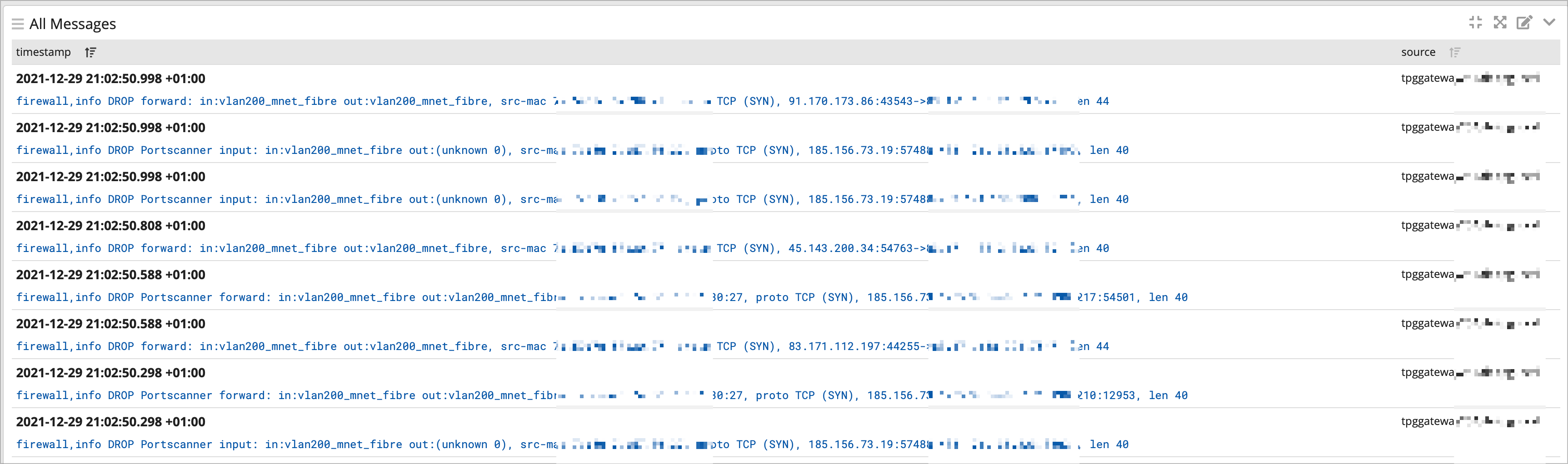

Messages:
