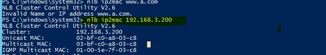

Sending unicast packets over multiple ports, that is the trick that Microsoft used for it’s Terminal Server Cluster. All Terminal Server servers must receive all RDP requests from clients, the NLB process would then assign the server that must process the request. https://docs.microsoft.com/en-us/troubleshoot/windows-server/networking/configure-network-to-support-nlb-operation-mode
Basic for this is to use unicast flooding. (It used to be documented that they used illegal MAC addresses to trigger this. Illegal MAC addresses cannot be stored in the address table of the switch, so the switch has to send it to all ports). With unicast flooding the switch acts as a HUB for it’s traffic control. So the easier setup was to insert a HUB before the servers. But fast Hubs are difficult to find, so a switch with permanent unicast flooding set is used. The disadvantage of that illegal MAC address was that all RDP traffic was flooded to all ports on all switches in the entire L2 network. VLAN and port isolation might contain this.

Not exactly - they used a multicast MAC address as unmanaged switches, or managed with IGMP snooping disabled, will by design not learn the address and flood packets to all ports.
Indeed not exactly, forgot how it avoided storing tn the MAC table. (Is a long time ago, but that’s the way I simplified the idea)
But there are 3 methods and, one was unicast (the one we used)
Found the detailed description: https://blogs.msmvps.com/clusterhelp/2006/06/24/network-load-balancing-and-mac-addresses/ (some SSL problem here)
Well … not so easy to implement on just any device.
"What each NLB node does, when sending traffic, is it spoofs the MAC as above except it replaces BF with the priority number. For example, if the NLB cluster node were configured with the number three as its priority (unique) number, then it would identify itself to the switch as being MAC address 02-03-c0-a8-02-0b. This allows the switch to happily enter the MAC Address in its table and have a one to one mapping of MAC Addresses to ports.
So, when an NLB client tries to connect to the IP address of the NLB cluster and does an ARP on the IP to identify the MAC Address, the switch fabric flips out because it can’t find any ports that contain that MAC address and thus flood the fabric. The use of the priority number stops the switch fabric from trying to learn the actual MAC address of the NLB cluster and provides a bit of sanity/reality for the switch so that it is happy.
So, to summarize, each client connecting to the NLB cluster will use the bf MAC address as the destination which causes the switches to flood all ports with the traffic. Each NLB node sends data using the priority number instead of bf to stop the switch from learning the bf MAC address and trying to map it to a single port. "
