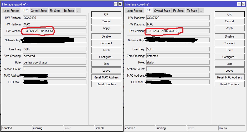

Please tell me where can I get firmware version 1.4.0 or newer for PL7400?
I do not see any firmware available… How can you tell that there is an update ?
I have several devices based on the QCA7420 chip with different firmware versions of the PWR-LINE module.
The problem arises when the modules work with different firmware versions on the same network, even under ideal conditions.
