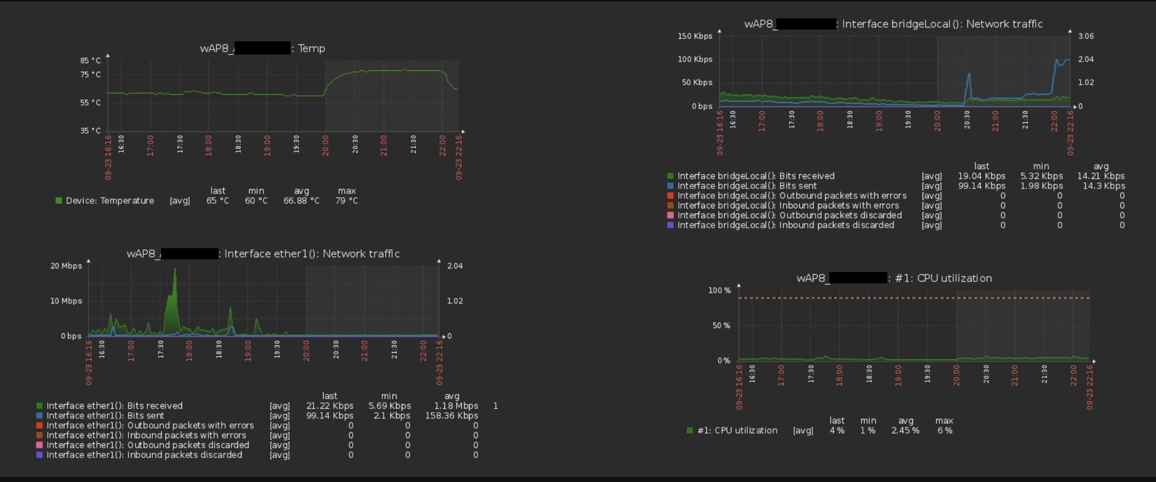

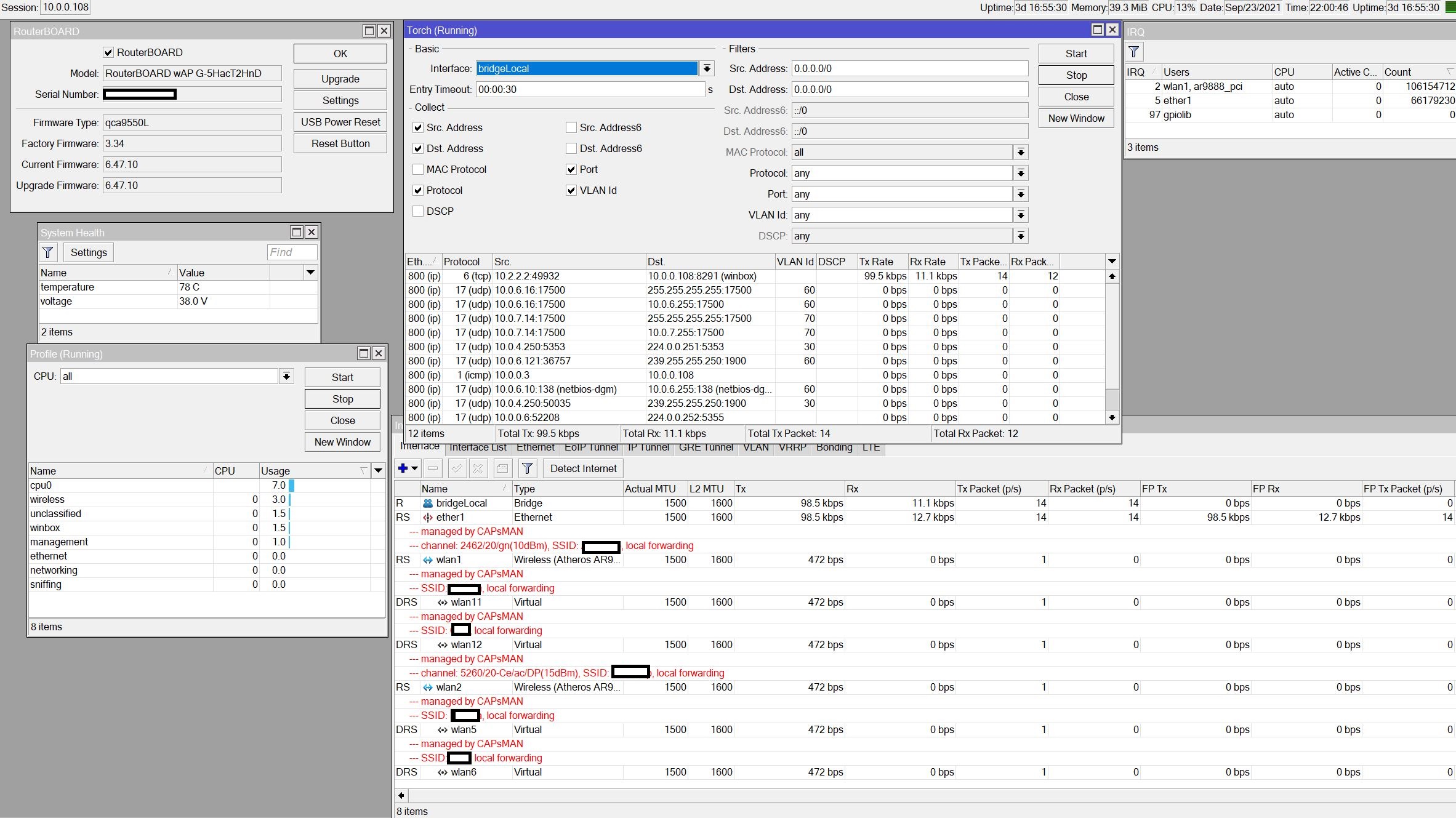

Got a lucky tonight so AP started to heat up while having 1 or 2 clients connected to this AP it didn’t stop forwarding traffic and didn’t reboot got some info(see screenshots)
sadly zabbix intervals were default by Template Net Mikrotik SNMPv2: Device (3m)
after 22:00 it started to chill by itself
i don’t know where to seek further.(
