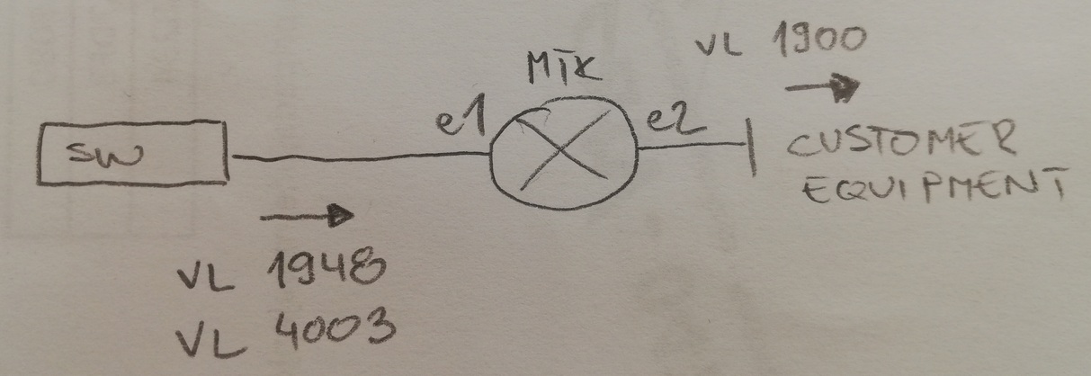

i am using RB750Gr3 (hEX), and it should do the following:
  • eth1 is the uplink interface connected to the ISP switch. it should carry only 2 vlans for now, vlan1900 (customer) and vlan4003 (hEX management), but they should be encapsulated in s-vlan 1948
  • eth2 is the access port for the customer, and the tagging should be done by hEX
    it seems to be a pretty simple setup, but i can not get it to work, i need some help with this! i am also aware that it could be done in more ways…
