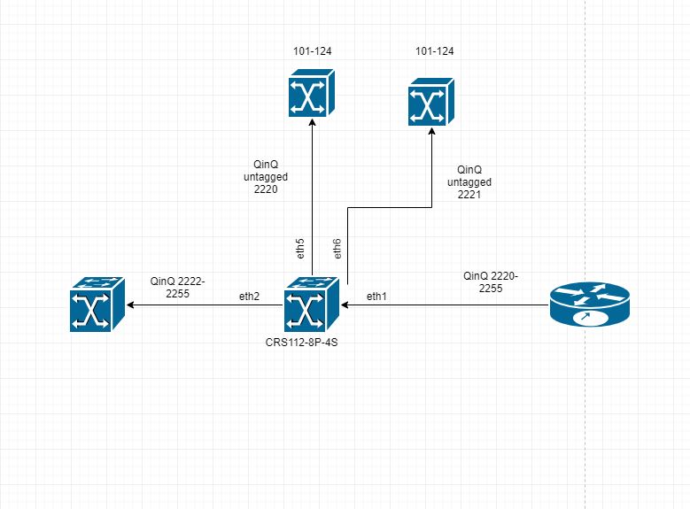

Hello, please help. How to configure hw-offloading QinQ untagged with tpid 0x8100 on CRS112-8P-4S? ROS 6.43.7. I am attached the scheme. On eth5 need to untag qinq 2200, on eth6 need to untag qinq 2201, eth1 is uplink (qinq as is), eth2 downlink (qinq as is).
Managment on vlan 4005, if i enter /interface ethernet switch set bridge-type=service-vid-used-as-lookup-vid that mikrotik disconnected, if i previosly enter /interface ethernet switch port set ether1 egress-service-tpid-override=0x8100 ingress-service-tpid-override=0x8100 that mikrotik too disconnected.
