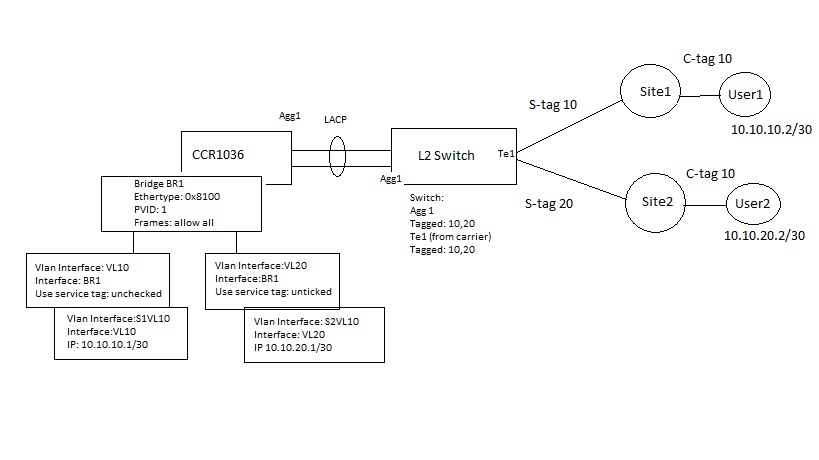

I have a CCR1036 configured to handle S-tag/c-tags from a upstream provider across via a layer-2 switch. Please see diagram attached. If there is anything that needs clarification, please ask.
Here is an extract of the config file:
add name=Br1 vlan-filtering=yes
add name=loopback0
set [ find default-name=sfp-sfpplus1 ] l2mtu=9216 mtu=9216
set [ find default-name=sfp-sfpplus2 ] l2mtu=9216 mtu=9216
/interface bonding
add lacp-rate=1sec mode=802.3ad mtu=9216 name=AggregatePort1 slaves=sfp-sfpplus1,sfp-sfpplus2
/interface vlan
add interface=AggregatePort1 name=Site2 vlan-id=20
add interface=AggregatePort1 name=Site1 vlan-id=10
add interface=Site1 name=S1VL10 vlan-id=10
add interface=Site2 name=S2VL10 vlan-id=10
add disabled=yes interface=AggregatePort7 (not sure why this line is here)
add bridge=Br1 interface=Site2 pvid=20
add bridge=Br1 interface=Site1 pvid=10
add address=10.10.20.1/30 interface=S2VL10 network=10.10.20.0
add address=10.10.10.1/30 interface=S1VL10 network=10.10.10.0
Have been able to get some basic connectivity working using the nested vlan interfaces.
I have a few questions about automation and scalability:
  1. Is there is a better solution for growth of network sites? Say 100+ for example
  2. I would like to use DHCP on the Bridge interface to reduce the amount of overhead when bringing on new sites. Does this need to be done per nested vlan interface?
