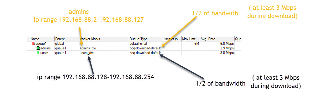

  1. I would like to find out whether my attempt to provide some QOS into my network makes any sense:
    In case when every group download something with maximium available speed:
  • I would like to give admins at least 50 % of bandwidth (during stress moments, pcq)
  • All users should have remaining 50 % of bandwidth (during stress scenario,pcq)
  • on the other hand, when network isn’t loaded hard, every user should get as much as possible.
I think everything works fine (during stress either admin and users get’s 3Mbps)
My question is, will (during stress) 50 % of bandwidth for users distributed equally among all of them ( for instance 6 users in this group, each of them should get 0,5 Mbps).
During tests i could check only 2 users + 1 admin, and i couldn’t measure how much will get each of them.
Please note that my packet marks with comments - “admin” and “users” contains IP pools (not single Ip’s)
Will this setup work for 10 admins and 40 users (of course with better connection)?

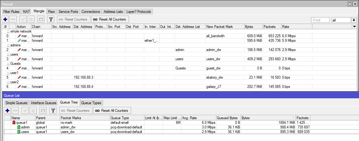

  1. I also tried to do some test regarding what i’ve mentioned above, but it doesn’t work. For this setup queue tree rules doesn’t work (but packet marks do) :
    all bandwitdh (passthrough ticked)
    users (passthrough ticked)
    user1 , user2 (passthrough unticked)
Users rule on Queue tree works only when untick “passthrough” in in action bookmark of “users” mangle rule, but when i do this " user1" and “user” 2 mangle rules doesn’t work…
How can i measure selected single user bandwidth for my queue tree ?

Hi
Equals distribution depends on the configuration of pcq: make sure you group traffic based on internal ip only.
Queue tree needs all packets to be marked with associated tag, so it will recognise it and assign to its queue.
Thank you for the answer, but still it didn’t help me.
I have two groups of users (i shared ip range for 2 parts). I need to know whether 1/2 of banditch will be equally distributed among ip’s inside each range.
In example above when i have connected 4 computers ( and everyone is downloading in the same time)
192.168.88.2 - should get 3Mbps
192.168.88.128- should get 1Mbps
192.168.88.129- should get 1 Mpps
192.168.88.130- should get 1 Mbps
Will my queue tree achieve this goal ? Is this efficient?
with
pcq-download set to dst-address
pcq-upload set to src-address
you will
