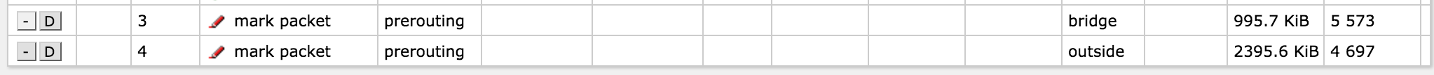

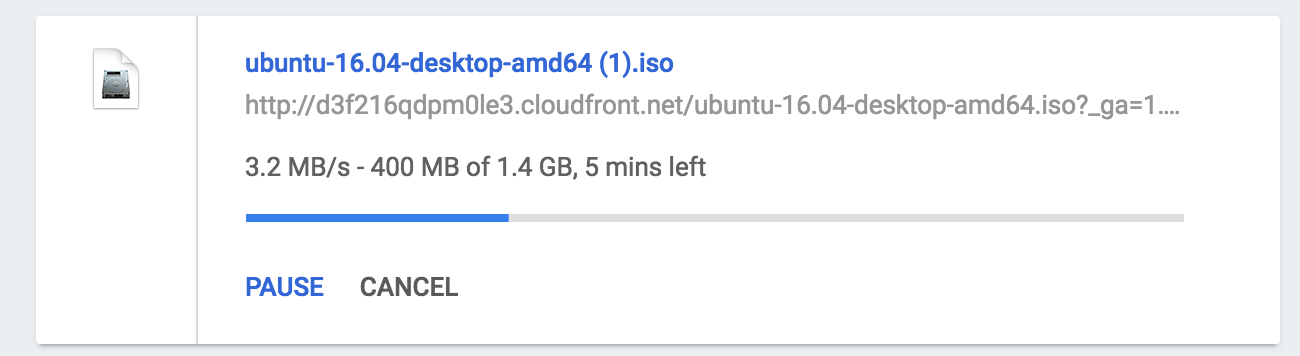

Did you ever figure this out? I am having a similar issue. I am downloading an Ubuntu ISO at 3.2MB/sec:
however, the firewall rules show only ~2000 KB downloaded total:
My rules are as follows:
/ip firewall mangle
add action=mark-packet chain=prerouting in-interface=bridge new-packet-mark=client_upload
add action=mark-packet chain=prerouting in-interface=outside new-packet-mark=client_download
