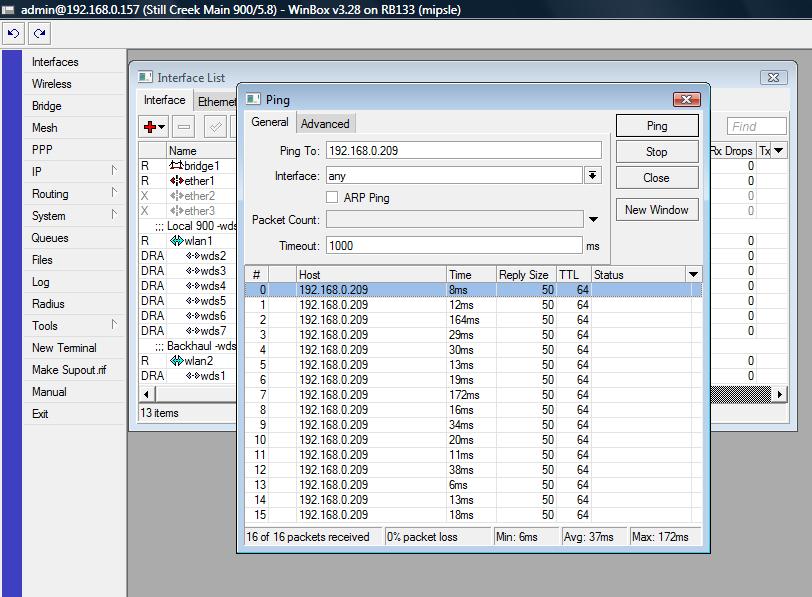

Thanks alot for the mangle help. I used your example of QOS and it seems to improve our network traffic. However, as for the Airave, I realized that I don’t think QOS will help it. I think my problem is with latency. My RB411 is getting its internet connection from an RB133 that’s located about five miles away (line of sight). I’m very often getting ping times of over 150ms, and I think this jitter is causing my problems.
So, if latency is the problem, is there any way to help my latency problems… either to lower them or keep them constant? Is the distance causing this? Noise?
Thanks again
Here’s my latency screenshot from one router to to the other:
This could go to re-engineering the point to point link, could need new hardware etc.. but can be greatly improved, yes. Check the CCQ values of the wireless cards …

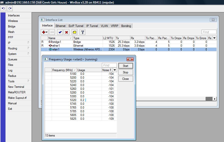

And here’s what I get when I check my frequency usage on 5Ghz:
Could it still be hardware or a setting I can try?
Go check antennas etc, fresnel zone, line of sight, any nearby 5G equipment that may interfere … go check.
Haha, I really wish I could check all of those. I don’t have any kind of equipment to check five miles (I don’t even own a telescope). I climbed to the top of our 75-foot tower that has the antenna on it and looked across the horizon. It looks like it is possible that there may be a two or three trees blocking the path.
Would trees cause these kinds of results? If so, am I SOL?
Anything in the way of the fresnel zone can cause loss in performance and low CCQ. Go cut the trees.
I would love to cut the trees but they’re on other people’s property, and I don’t think they’d understand that I’m trying to improve my low CCQ :laughing: The routers are owned by the same business, but located on different properties five miles away from each other… So I guess I’m screwed, or we can spend hundreds and add more height to the 75-foot towers. Thanks for all of your help anyway.
