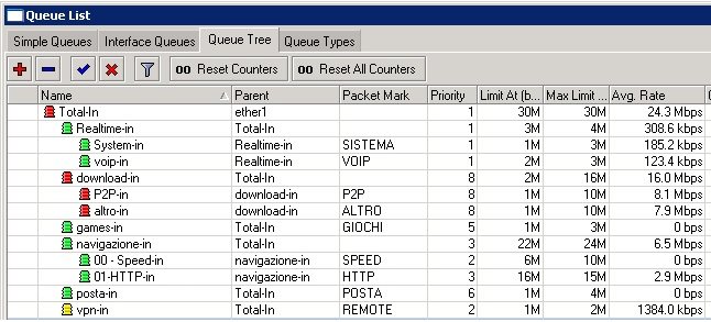

In my qos implemetation (I have a 30Mbit internet connection shared to 700 users) I mark different types of traffic then I give more or less priority to the different types.
The sum of Limit-At of all queues is = 30.
I have limited also max-limit for each queue but I don know if this is a good idea:
could it be better to set max-limit of each queue to 30Mbit (full bandwidth) ?
In this case, each queue could reach the maximum bandwidth, and each queue figth with its own priority.
Is this correct ?
thanks
Each queue, after satisfying limit-at will contend for bandwidth based on priority. You’ll need to set max-at (at least in the root queue) for HTB to work. Btw, priority QOS only works on leaf queues.

thanks rmichael.
do you think in my implementation there is something wrong ?
I’m still learning this stuff, but it looks OK to me. Next, I would suggest that you look at your queues and see how many packets they drop.
Normally you want to drop as little as possible for down traffic and low priority traffic first for uploads.
To maximase bandwidth use for tcp traffic make sure that you don’t drop ACK, SYN-ACK packets - you should propably put them in a separate, high priority queue. That way you can also monitor and act on SYN flood.
Michael

If a queue drops too many packets (and is a download queue), is a good idea to enlarge the buffer size ?
Yes for TCP flows, generally no for UDP flows. Try to tune so packets of low importance get dropped first.
