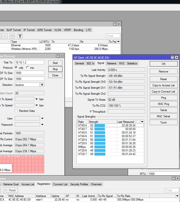

Also, this is what a pair of them can do >
soulflyhigh, what is the distance for this wireless link using QRT2?
500m, we’ve reduced wlan output power down to 17dBm on both sides (signal level was -32dBm with full power).
That is excellent.
How about noise environment? I can see noise but does this link is located in area with lot of wifi traffic?

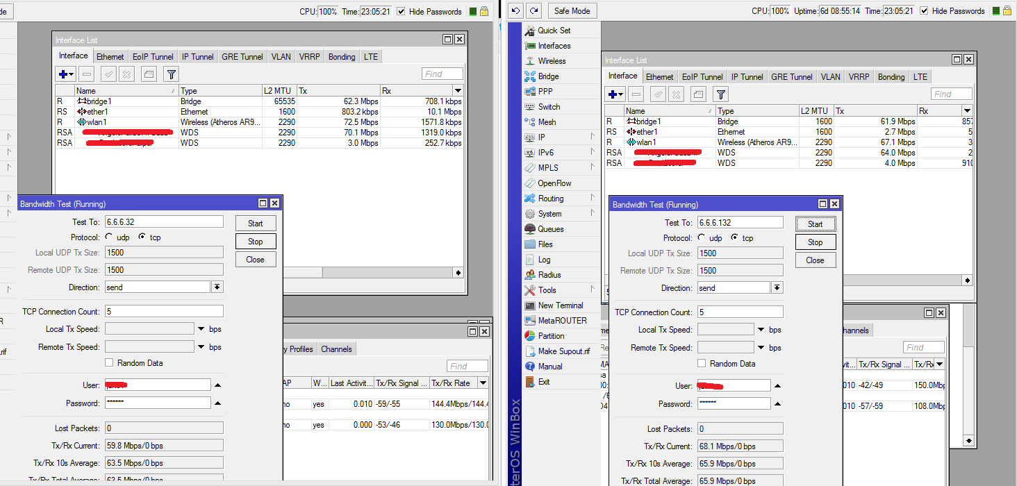

This two SXT SA are placed about 30sm one from other (at first it was for a test but I left them that way) in opposite direction + I have 3 more units on this collocation (OmniTik, 2x sxt)
frequencies are 5580 and 5700 channel 20Mhz width - both are p2mp SXTSA->2xSXTHP distance of clients are from 1km up to 2km (+I have OmniTIk about 2 meters from both units that operate on 5500MHz two SXTHn older version are set below 5300)
test is made in same time (parallel) on both units, TCP btest + actual Internet traffic
20Mhz channel width (not 40Mhz above,below), units are placed 30sm ,nstreme, P2MP, in same time both units can send almost 70Mbits TCP- throughput is almost max out amazing :slight_smile: I m talking about test in real world, area with high noise not in laboratory - but if I had little more CPU power :slight_smile: btest “throughput” can go up to 80Mbits excellent excellent done Mikrotik - cheap way to beat expensive gps syn what so ever if it works or does not
before that I had 2xgroove 23dbl than changed with sxtHP- but HP was much more powerful, thats why I created this topic QRT has 35Db - I had to change tx-power to 20db, had to set first HP to 5180 second to 5700 but performance was not even close to SXT-SA definitely it was collocation interference
But how? :astonished: I never made setup or saw more when 200Mbs real UDP throughput on 300Mbs modulation with CCQ about or just 100%. Is this new hardware benefits (CPU or radio) or just some good configuration?
