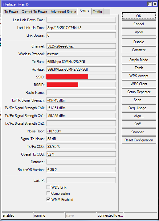

I’ve realize a bridge with two abotation at 800mt with two QRT. In this bridge, i’ve create foru VLAN, for transport it more device.
One VLAN is for LAN, one VLAN is for GUEST, one VLAN is for transfer HDMI signal with HDBitT module LKV383 and one VLAN is create for the future utilize.
At the “eth” of the two QRT, is connect two RB2011 with configurate respective VLAN.
For this transfer, I use NSTREAME Protocoll with FULL Multicast Helper.
The link is OK, but some times i’ve a disconnection and in log i view the message " Extensive data loss".
The signal and CCQ is OK, i don’t understand were si the problem.

Thank you so mutch for the help.
Hello. I think i’ve solved my problem .
I’ve set Framer Policy = exact size and Frammer Limit=4000
I Test IT, but in this mode i’dont have disconnect.
