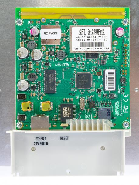

Are you looking at putting the 911ac radio in the QRT5, we need a midsize panel aerial for some sites where the sxt 16db radio is to small and the 30db dish is to large, i assume that i can install the 911ac radio the QRT5 if i pop the back off.

if you use router similar in form factor as one that is already there, you can easily replace them.
So what is the board in the QRT5?
Adrian
http://www.cdr.pl/galerie/m/mikrotik-routerboard-qrt_5061.jpg
It might be very possible that qrt5 will be using the same board, so you can.t replace it.
This is QRT2 - it is different
QRT5 - have rb911G inside
So i was correct, i can replace the 911 with the 911ac board then

yes you can!

it seems that i forgot to add that it is RB911 in my previous post :slight_smile:
Please excuse me, but I must correct the above. QRT is not directly compatible with the new AC boards because they have different location of the Ethernet port, and also different LED positions. This is because new series of boards have a place for SFP module, so ethernet and LEDs are shifted to the right.
