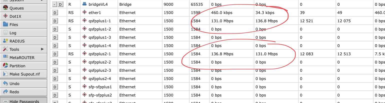

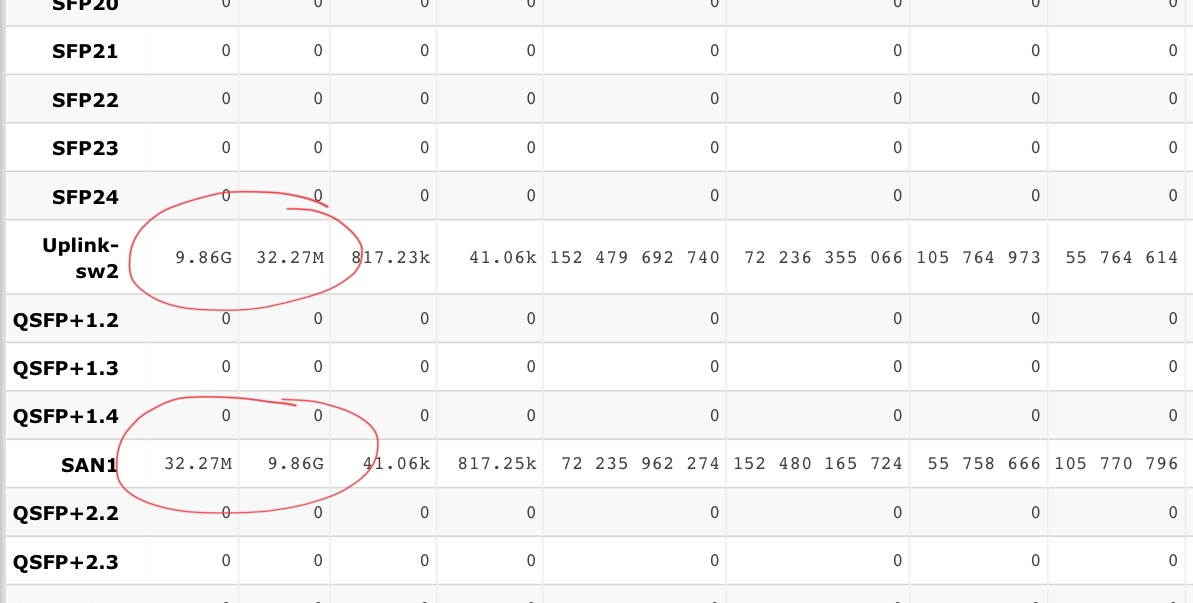

With SwOS i can utilize the 40Gbps connection. The problem i have is with RouterOS. I only get 100Mbps traffic speed, maybe for a fraction of a second 200Mbps. No where near the 40Gbps. What am i missing?

SwOS - 2GB ISO file copy between 2 datastores - 9GB
RouterOS - same ISO copy to same datastores - 130Mbps

Well that was a short Eureka. After booting everything up again, i experienced the same issue with RouterOS 6.49.2. Speed is around 100Mbps.
Switching to SwOS gives me full speed. I’m lost at what is causing this. Enabling/disabling autonegotiation does not work and i haven’t changed a thing since yesterday after the upgrade.
