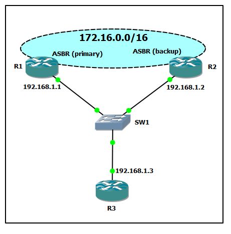

I have replicated the problem with the following setup:
R1 and R2 are configured as ASBR routers - redistributing static into OSPF as Type-1 external routes.
R1 has a static blackhole route for 172.16.0.0/16
R2 has a floating static backup route for 172.16.0.0/16 with distance set to 200.
OSPF uses area 0 on the 192.168.1.0/24 network.
R3 is present just as a client showing what other nodes will see advertised from R1 and R2.
Here are the configurations of the routers:

While everything is normal, R3 shows:
[admin@R3] /ip route> print where dst-address=172.16.0.0/16
DST-ADDRESS PREF-SRC GATEWAY DISTANCE
0 ADo 172.16.0.0/16 192.168.1.1 110
If I disable the route to 172.16.0.0/16 in R1, then R2 takes over properly:
0 ADo 172.16.0.0/16 192.168.1.2 110
When I re-enable the static route on R1, then R2 refuses to drop its advertisement based on a 200-distance static route, and R3 now has an ECMP balance route installed:
192.168.1.1
Obviously, the ECMP could be fixed by modifying the base metric injected at R2, but this is beside the point - the point is that clearly the lower distance path to reach 172.16.0.0/16 at R2 is the OSPF path, which has a distance of 110.
However, OSPF is IMPROPERLY ignoring this update due to the fact that it is already originating this route based on its own static route.
