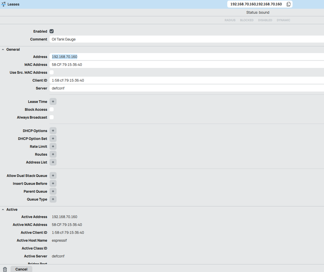

If you mean a statically assigned (i.e., remembered) IP handed out by the DHCP server, it already has that.

Is the behavior normal: Whenever a wifi client disconnects and reconnects, even though the DHCP server sees the assigned (or dedicated or even static) IP, both the wifi dis- and re- connect as well as the DHCP assignment will be logged under topic INFO?
Anything I can do to exclude a single client?
By definition DHCP client has to assume network change when connection droos (even by s fraction of a second). So it’ll do it’s job.
