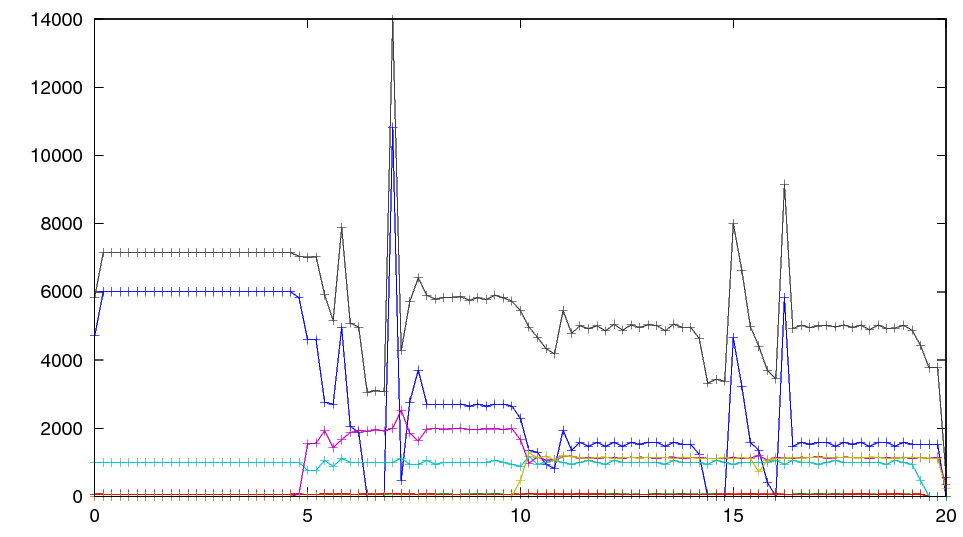

HI
Please , i need your help,
I attached my configuration for htb (QOS) , i have a point to point: PUCP----UCLC (using 2 mikrotik , rb433ah),
my lan network is 172.16.1.0/24 and my other lan is 172.16.3.0/24,
i have 4 categories (voip, video, dedicated and besteffort), voip and video with mayor priority,
my problem is that i want limit the besteffort trafic always , but besteffor never down and fight with my voip and video traffic. I need that my traffic of besteffoft down when i am inyecting video and voip traffic,
please , help me!!!
i atacched my configuration, and my picture (with the bessteffor in color blue, i can´t have this traffic for below the traffic video, i tried with down his max-limit ) the other traffics are videoconferencia and voip,
configruation:

My total bandwith=11mbps
please you can see the picture with 3 types of traffics:
  1. i inyected besteffor traffic with bandwith=6mbps, for 20 seconds = color blue
  2. i inyected video1 traffic with bandwith=1mbps, for 20 seconds = color green light
  3. i inyected video2 traffic with bandwith=2mbps, from=5 seconds to=20 seconds, color=purple
  4. i inyected video3 trafiifc with bandwith= 4mbps, from=10 seconds to=20seconds, color=brown
    i inyected voip traffic too., 2 voip calls- priority=1
