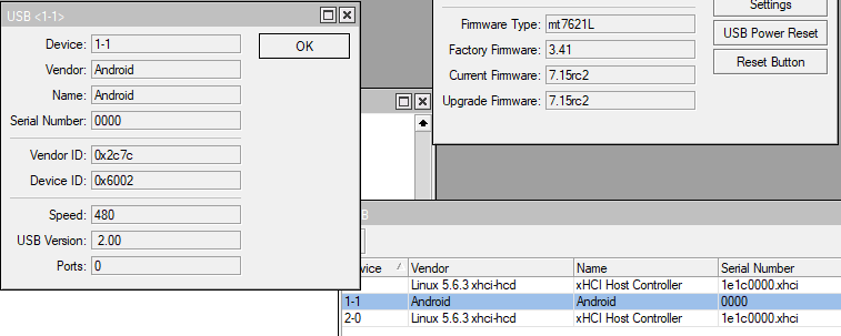

we would like to use the Quectel EC200S-EN 450 via a USB miniPCIe adapter.
The card is recognized in MBIM mode, but it is not possible to send AT commands to the card “failure: Modem unsupported!”.
In serial mode via ppp, RouterOS does not receive an IP and aborts.

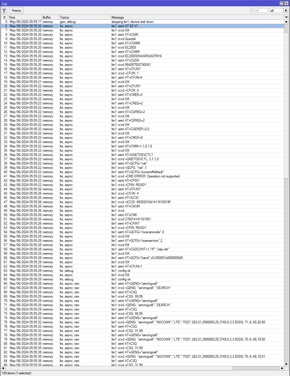

if I change the USB device ID from 0x6002 to 0x6005, RouterOS configures the card and the card goes online, but the LTE interface does not receive a running state and say “NOCONN”
