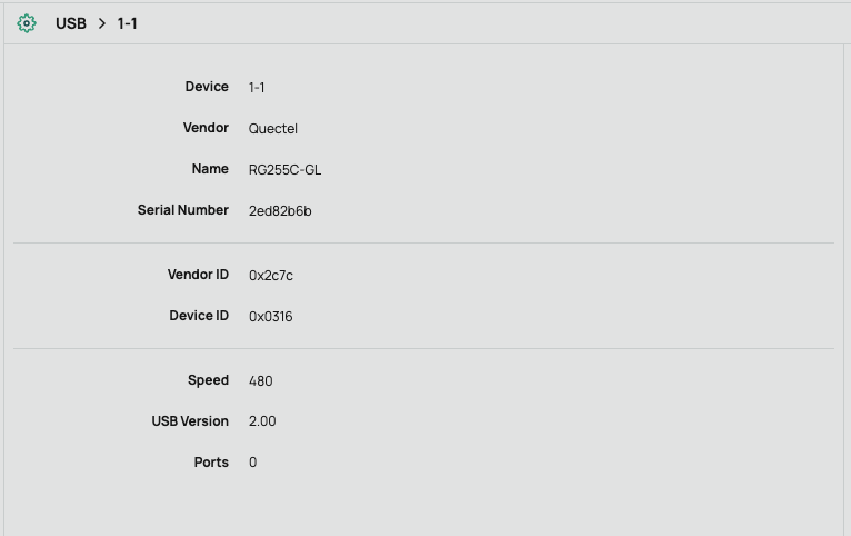

I know this is a super new product and not many of them out there, but I recently got my hands on a Quectel Redcap RG255C-GL modem to give it a try.

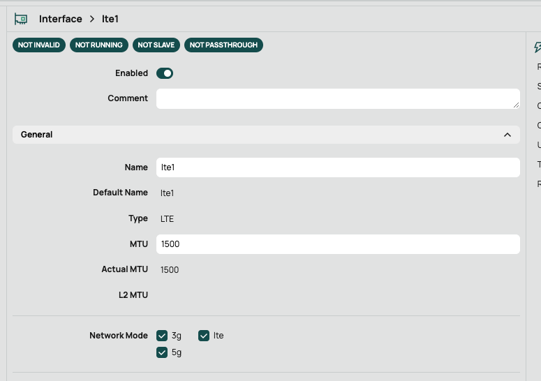

I can see RouterOS recognises the modem but unfortunately it doesn’t seem to be able connect. The interface won’t go into the running mode despite having the APN set and I’m at a bit of a loss as to what to try next. When it comes to LTE modems I’m very “wet behind the ears” and well out of my depth at this point. As I understand there are linux drivers for this modem but I don’t have a machine that I can put this in to see if it will work there.
If I try to do a “Scan” it shows up “Couldn’t start, radio off (6)”
Any help here or do I just have to wait for the drivers to catch up? Happy to provide any logs or device information necessary - I just have no idea what’s needed to help you guys all help me make this work. I had hoped that the quectel drivers would allow this to work, and the wAP R does recognise it, it just seems it can’t do anything with it.

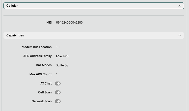

Same issue here, RouterOS recognises it, but it’s not starting. Quectel RG255C-GL on an LTAP Mini running RouterOS 7.16.2
EDIT: RouterOS logfile has a line that says "lte, error lte1: no response for AT E0 V1
