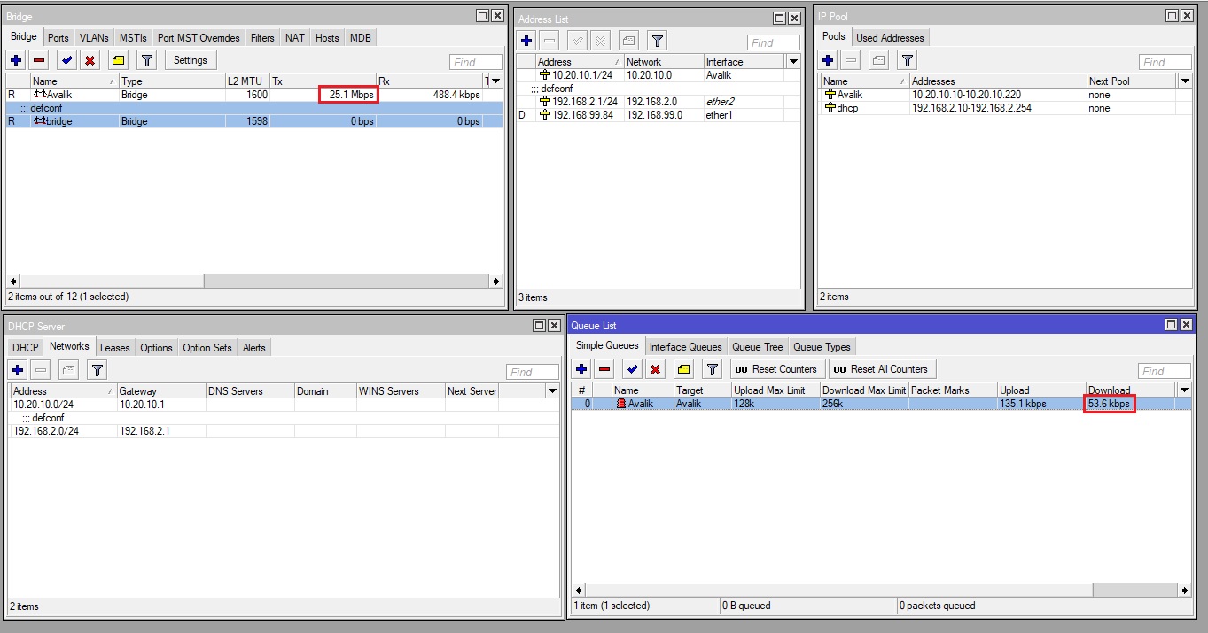

Thanks for the advice but it doesn’t seam to work ether. Here’s what I did:
  1. Reset mikrotik
  2. Using the default settings. Changed the Network name and added Guest Network named Avalik.
  3. Created new bridge named Avalik and added wlan3 (guest network interface 2,4Ghz band) and wlan4 (guest network interface 5Ghz band) to the bridge
  4. Added a Address list to interface Avalik (the new bridge)
  5. Added a IP pool
  6. Added a DHCP server that uses the new IP pool
  7. Added a new network under Dhcp server. Now the Avalik network uses the new dhcp server and internet works. I get 22,4 Mbps download speed on speedtest app
  8. Added a simple queue named Avalik and the target is bridge named Avalik. Upload limit is 128k and download 256k.
    Thing is that the upload and download limits still don’t work.
    I added a picture of my configuration and on the bridge window u can see that the bridge shows 25.1Mbps download but queue window shows 53,6 kbps.
