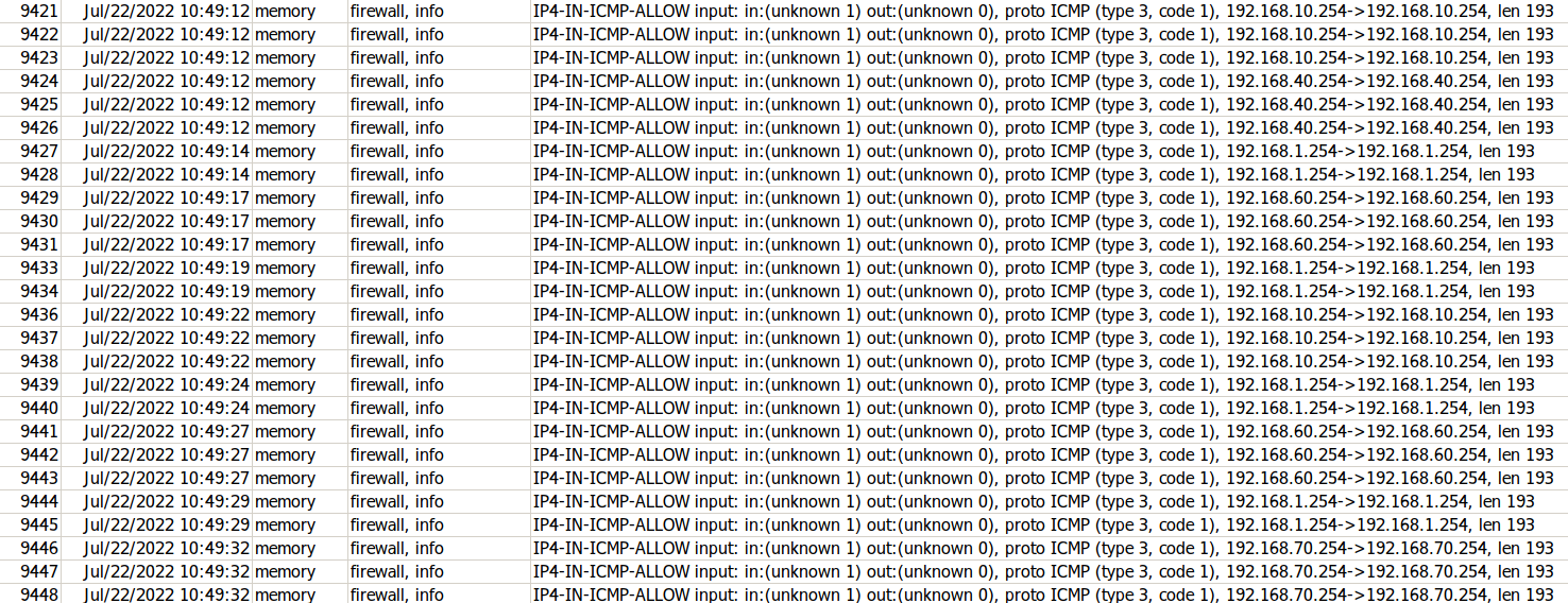

Speaking of ICMP, there are some strange things that I cannot address on my RB5009 / 7.3.1 (and it was with other 7.x releases also)
I was logging all ICMP on the INPUT-chain and see thousands & thousands of these passing by.
So why is this Mikrotik issuing “Type 3 , Code 1” messages from itself to itself ?
Type 3 = Destination Unreachable
Code 1 = Port Unreachable
All these interface are VLAN L3 192.168.x.x “IP interfaces” of LAB-segments and perfectly reachable for example…very weird.

Interesting find, that current ICMP rule does not have any IN or OUT “interface-list” applied, everything is left “blanc”
The moment I edit the rule and put “all” … suddenly the logging of these hits STOPS
Now just below this rule there is default DENY on anything on the INPUT-chain.When I disable my custom ICMP-rule suddenly my DEFAULT IN DROP start showing these ICMP-loggings.
The last DROP-rule also does not have “all” field populated at the in-interfaces-list field.
Sooo … I always believed there was no difference between using “all” interfaces-list and just not putting anything in there “blanco” … but behaviour is different.
The moment I put “all” on this rule in the IN “interface-list” field, this excessive logging goes away…
I’ve checked with CLI too, remains the same. In the past some Winbox config ends up differently on the box then using pure CLI…

OK, so at least I know what causes this.
all = all visible interface on dropdown menu
“” = all visible + all not visible, like local loopback
is why everytime I reccomend to not block loopback traffic…
Thx for pointing that out, it had to be something like this...
MT should better document that and update their Wiki somewhat.
"all" =! all :laughing:
