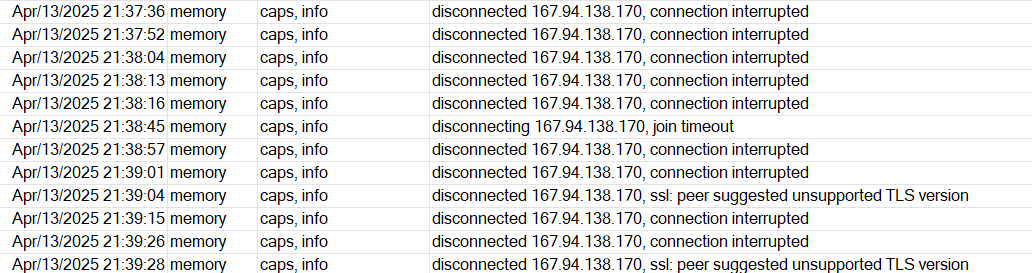

In the last week I get a lot of caps.info logs showing different IP addresses are trying to connect throught capsman, but the router is basically disconnecting them, I will add a screenshot of you to check what I mean.
I checked the IP addresses online, they are definitely malicious and I understand my router are blocking the connection, but I need to know how can I check the actual port of the person who is trying to connect, and how can I stop this, kindly note that this is not only one IP address, but I want to show you an example of the log.

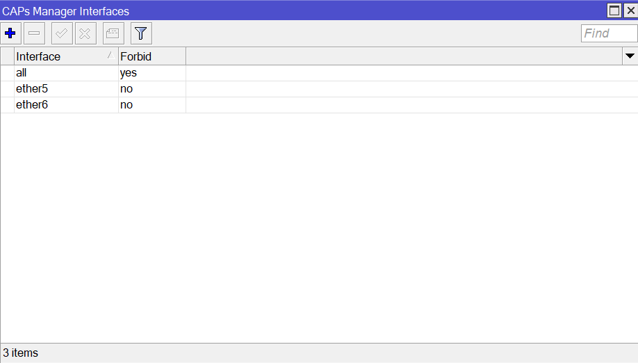

this is also a screenshot of the CAPSman interface, is this correctly assigned if the interfaces 5-6 have the Caps connected?
