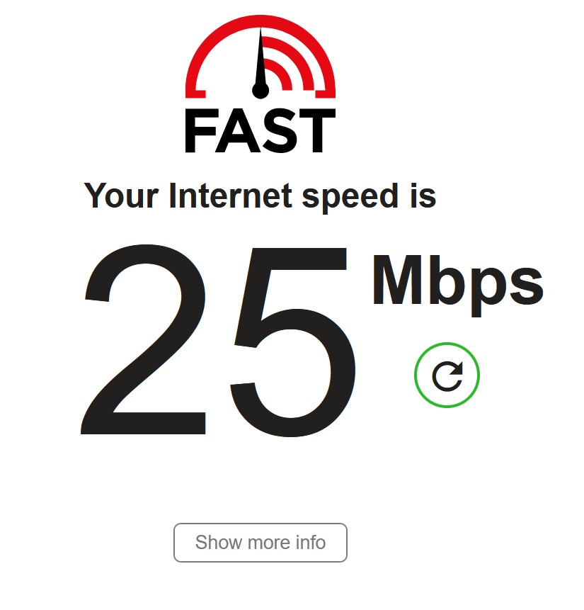

Hi, just wondering why my Simple Queues are not limiting based from my configuration.
I want to limit the IP 192.168.88.251 to 10M only, but when I speedtest. It still in the full bandwidth allocated from ISP.
Is there any thing that I’ve missed?

Yes, as much as I like the Fast.com speed test, I don’t think its the most accurate. I can get inflated numbers when I do tests with it, yet when I look on the interface on the router I’m seeing the ‘real’ numbers. Use something like speedtest.net or dslreports speedtest as these will give more ‘accurate’ numbers.
If you want to know a queue is working correctly, max it out and watch it go red when it actually is kicking in. If it isn’t going red then its not being maxxed.

Hi, ether2 interface will not work as a target - you need to use a subnet (ex. 192.168.88.0/24). You will likely also find that you need to set max limit on the “all bandwidth” queue for upload and download in order for it to work.
