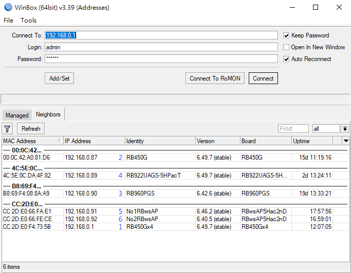

Here is what I have for my home network.
#1 WAN to ISP. CAPSMAN host.
#2 switch only.
#3 switch only.
#4~#6 wireless APs managed by CAPSMAN
I am thinking about adding another hAP ax². However, it only came with V7. Will it still managed by current CAPSMAN?
Do they all need to upgrade to V7? Thanks in advance.

Side note: I see 3 devices which may have to be upgrade to latest ROS6 version …
Thanks for the reply. The CAPsMAN is currently on RB450GX4 which I mentioned as CAPsMAN host. You are right about the 16MB storage problem. The one with older versions are with 16MB storage. They can’t do the upgrade from WinBox though.
I will probably do you’ve suggested. Just use AX2 device alone to avoid all the trouble.
