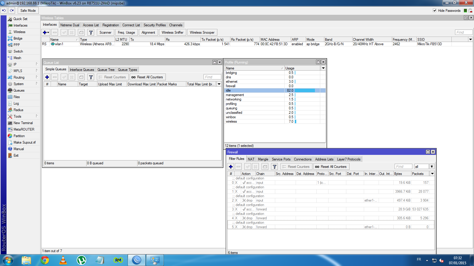

I have a mikrotik router, his name is rb751u 2nhd. with my local network, I can’t download files more than about 2Mb/s. I’d like to know if it is normal for this router, or if i can do something to make it better.

No. It is much more for sure. But you can have queuing or very hard firewall settings that could limit the throughput. Observe tools profile what occupies cpu when downloading.
thank you for your answer. can you explain what is “queuing” ? i did not tell you , but i try to download with my samsung galaxy tab. i don’t know if there is a firewall on it… i don’t think so. do you mean a firewall on the router ? how can i observe tool profile ?

i have tryed to switch off all the firewall on the router and on my pc… always the same : 2,14 Mb/s on my galaxy tab4… i don’t understand the problem… if there is a problem… on winbox i can read on wireless table Tx = 20 Mbs… maybe something is wrong with my router configuration ?

That could be the reason. Also you maybe set wifi settings in wrong way. Or your tablet is not able to process faster download. Hard to say. Paste here your configuration export and provide values from wireless registration tab when downloading at maximum. And also look at could utilisation at that time. Provide clients ccq measured at router. If you don’t understand terms, read manual first.
2MB/s can be normal for G standard on RB751U-2hnd. I have the same transfers on my tab. I work in a noisy enviroment, maybe you do to.
