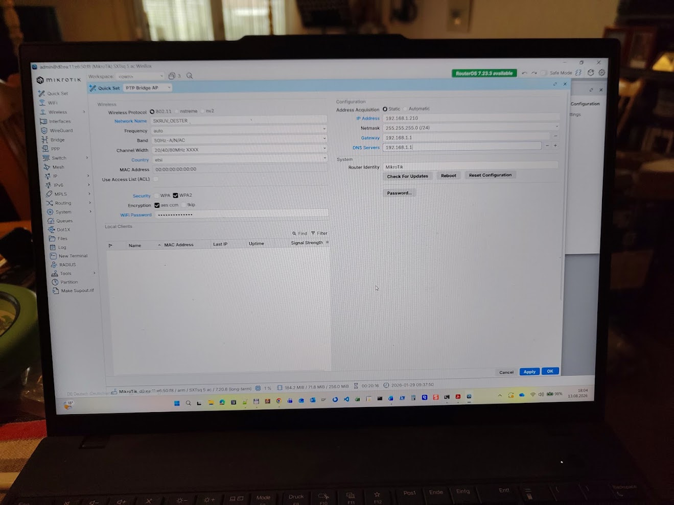

I started by mounting and configuring the first device at House B, but suddenly it became unreachable. Running ipconfig, I got the following output:
Connection-specific DNS Suffix .  :
Link-local IPv6 Address           : fe80::1e91:e1a9:9e88:7c64%9
Autoconfiguration IPv4 Address.   : 169.254.164.89
Subnet Mask                       : 255.255.0.0
Default Gateway . . . . . . . . . :
I could see the device was still somehow connected, but trying to access 169.254.164.89 only resulted in a "Connection refused" error. This is pretty frustrating, because now I have to climb back up the ladder and struggle to press the reset button. I guess it’s a much better idea to fully configure everything on a desk first before mounting them!

Hello everyone,
I set up the first device (MikroTik SXTsq 5 ac), which is connected to my internet router. But after I clicked "save", I could no longer find or access the device—neither via its MAC address nor its IP address.
