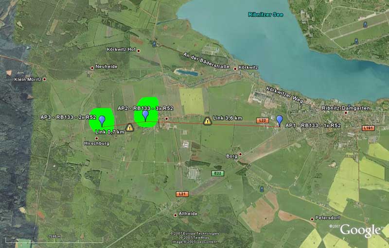

Hey all,
the goal is to built up a backbone to provide internet.
Internet will be at *AP1 (RB133 1xRC52)
24dbi Panel
Link 3,7 km
24dbi Panel
*AP2 (RB133 3xRC52) --> 1x Omni
18dbi Panel
Link 0,7 km
18 dbi Panel
*AP3 /RB133 2xRC52) --> 1x Omni
What settings I have to do?
Ralph
DSL für KHN
I have tried a configuration like it is described on wiki.mikrotik.com.
WDS-Bridge between the 3x RB133.
Would you recommend the config or mention another one?
Ralph
your choice looks ok.
I prefer AP3 connected directly to AP1, not through AP2.
Is not possible because there is no direct sight between them so I have to go over a relais.
Ralph
oh, ic… so should go with repeating your signal on AP2.
