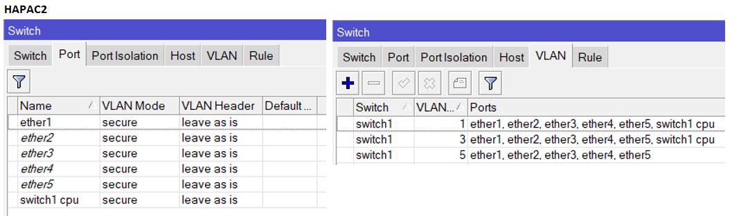

My network is running fine. However I have a question on the different treatment of default vlan id (0 or 1) across different products for switch chip VLAN implementation.
On the HAPAC2, this is the setting: (I assume with the port default vlan empty, it defaults to 1)
On the Powerbox, the default port vlan is 0 (which I assumed to be treated the same as 1). However, if I don’t add “vlan=0” in the switch vlan table, when I enable “VLAN Mode = Secure” for the uplink port, the winbox connection to the switch cuts. Now I am thinking MT treats vl 0 and 1 differently (whereas I previously assumed they are treated the same way).
For trunk ports, should I:
  1. Set the default vlan id on the HAPAC2’s ports to 0 and add VL=0 to the vlan table? or instead
  2. Set the default vlan id on the Powerbox’s ports to 1?

RoS is the same but unfortunately the variety of switch chip used seem to be the fly in the ointment so to speak. I am out of spare Powerboxes and HAPAC2s to test but my feeling is HAPAC2’s switch chip native pvid is 1 whereas Powerbox’s switch chip native pvid is 0.
