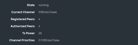

I’m asking this because I notice that when I specify 5GHz AX in the Statue section at Channel Priorities I only get 0:5180/ax/Ceee

I’m wondering if there’s any impact on performance (of the router itself and of the connected devices) if I specify these parameters in my customers’ routers.
This is in order to have the best possible configuration for an environment that contains as many AX devices as non-AX devices.
