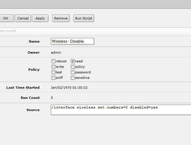

I have set the following for disable, but it doesn’t disable the wlan after run. Why?

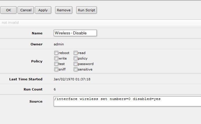

Okay, I leave it as default (not select anything for policy). After Run the script for disabled, the wlan still enabled.

Check all of the policy boxes, save, and try again.
The script setup completed.

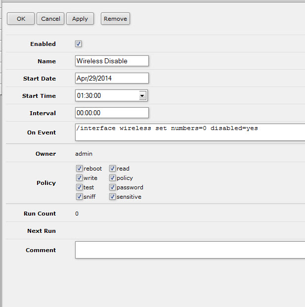

I would like to set as the following:
Disable at 01:30
Enable at 05:45
Does the following set is correct?
It should be like this. Don’t forget to set your NTP Client on your router.

As I would like to disable the wireless at midnight (01:30), hence, does I fill “start time” for 01:30:00 and Interval for “00:00:00”?
And, does it perform this script everyday?
You don’t need to set interval. Yes, they will run daily.

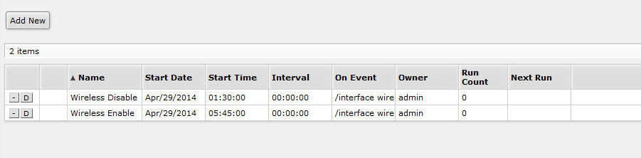

Hello Brown,
As the time is passed in my time zone, the scripts has not been ran. You can see the run counter are “0” in the screen captured. Why?
According to the log, it has not show the script has been run, too. why?
Because you have 1:30 which is AM. You need 13:30 for 1:30 pm.
Nope, I would like to set 01:30 am. Does it is 24 hour format as 01:30?
Wrong interval. Write "1d " before zeroes.
But, for interval, does it need to input a time format value, instead of “1d”?
