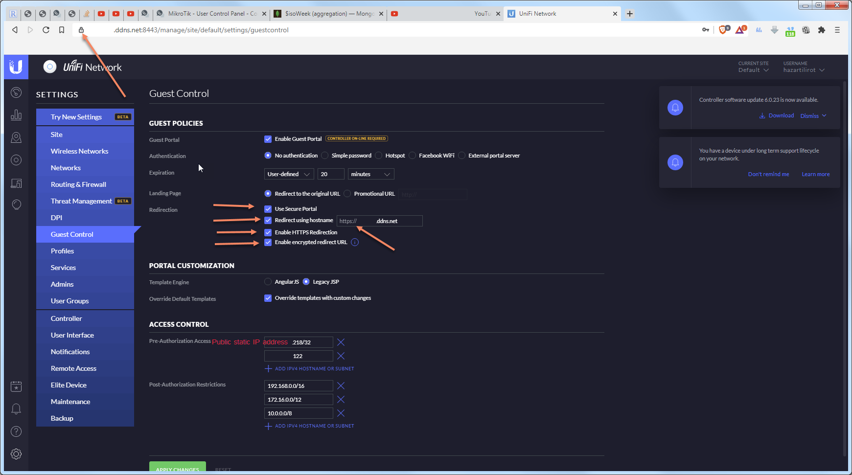

Here’s my settings (see the attachment)!

I’ll still doubt your words, because there simply isn’t any such mechanism in https (specifically in tls part, which handles the encryption) that would allow server to tell client “hey, forget about connecting to X and connect to Y instead”. :slight_smile: I’m sure the checkbox for redirecting https has some purpose, but the question is what exactly it does.
