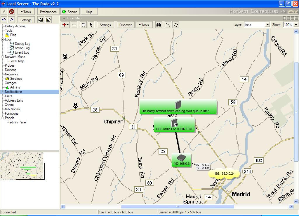

Hi guys, During my quest to become a Wisp im coming againts a few things… Here is my issue. Im using usermanager for authentication and radius, I can set a AP tx limit and a client Tx limit in usermanager. And that will queue everybody that mite hook up to that CPE unit weather it being a switch or what not. My problem is I would much rather use simple queue per household or CPE unit, Main reason for it is, I can keep track of there names, i can see there current usage in TX,RX , i can see total upload and download used ( I know in usermanager you have that) AND and this is the big one i can Limit PTP users i can use Burst with simple queue’s. But if set the simple queue to a Ip address it will just queue that IP address.. Im looking for a better way to beable to queue a household using simple queue, Not the AP Tx, limit and client Tx limit propertie… See attached picture.
Hopefully somebody can set me straight on what to do or im just plain stuck with AP tx limit, and Client Tx limit. Thanks -Jordan
