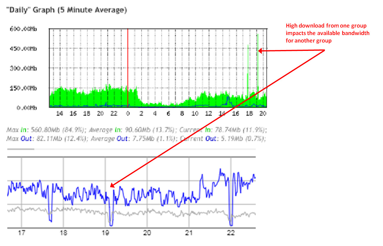

This appears to be not the case. From time to time very high download are initiated from one station, peaking at 600 Mbps or more. During these periods the other groups have less than 330 Mbps.
A few of these events, lasting up to 10 minutes, are visible in the screenshot below.

Actually - the other groups were cut - you can see that in the picture for one group. This dropped from close to 100 Mbps to near zero (scale is missing in the lower picture - max is 150 Mbps). The other group had similar drops - dropping from about 180 to close to zero. I would have expected the 300 Mbps at-rate to be honoured.

Another event occurred last Monday - caused by high downloads from one user. I noticed - using the graphs that the input to our main queue was receiving near 1000 Mbps.
See below. The queue of the group with the client initiating the traffic peaks at 660 (see below second graph).
The other groups were affected as last time.
