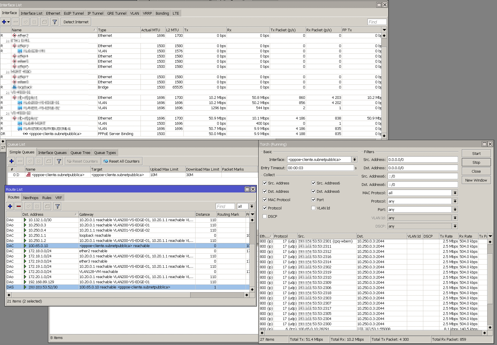

If I do a bandwidth test from an host that has the second usable address of the /30 to an internet router the upload queue works so 10M but the download queue does not match packets so it’s ignored and I get unlimited bandwidth (50M in this case)

  • Queue UP/DOWN for packet originated from the PPPoE assigned address works
  • Queue UP for packet originated from the routed subnet to PPPoE works
  • Queue DOWN for packet originated from the routed subnet to PPPoE NOT works
