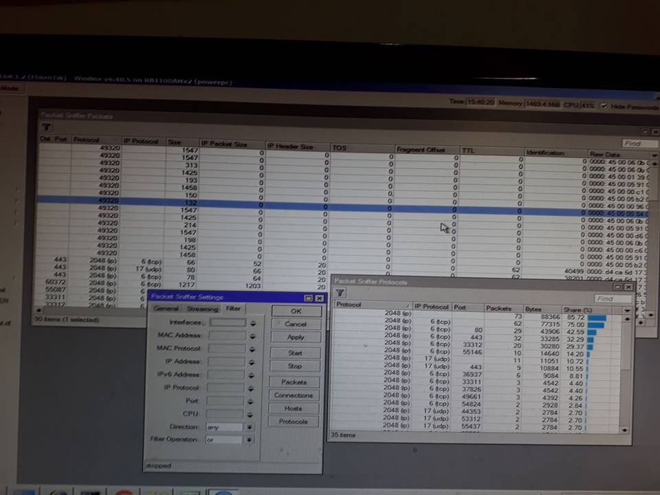

I executed packet sniffer , this is result
