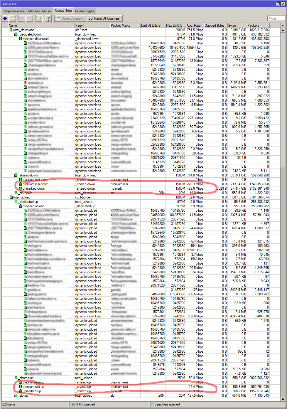

We are struggling with PCQ’s on our network getting overloaded and things just slow down … having a really hard time figuring out why. Until today - I read this and wonder if this is related:

I have a 10G port coming in and a 10G port going out. Download is one interface and upload is another interface.
To fix this problem should I create a bunch of vlans across that 10G port just so I have additional interfaces to use in HTB? I can just use a bunch of /30 ip routes and ospf will automatically load balance things of course.
Or should I get rid of queue tree and move everything to simple queues - seems like a bad idea.
I can only get about 800mbps thru this CCR72 with 90% of that traffic on two single PCQ entries. . . seems to work perfect until it gets busy at night. I would have thought this router (4 of them actually) could handle 1-2gbps easily but I guess not.
In this forum post I see MacGuiver states you can split things up by subnet, which I tried in queue tree, but they still all end up under same parent. Just so I understand, I need more interfaces not just queue entries right?

thank you. I created 4 vlans and duplicated queues under each and that really helped.
problems though … i cant tell all 4 interfaces how much bandwidth the parent really has.
sometimes the parent (real) interface still grabs all the traffic (no-mark) even though none of the traffic is routed that way, its all using vlans … not quite sure if its just “peering” into the vlan and deciding to help out or what. i disabled all those real interface queues and then vlan queues get the traffic. and then one of of the routers i did this on I had to disable and reenable the entire tree a few times to get things to actually work - every once in a while one of the vlans wasn’t being queued at all.
